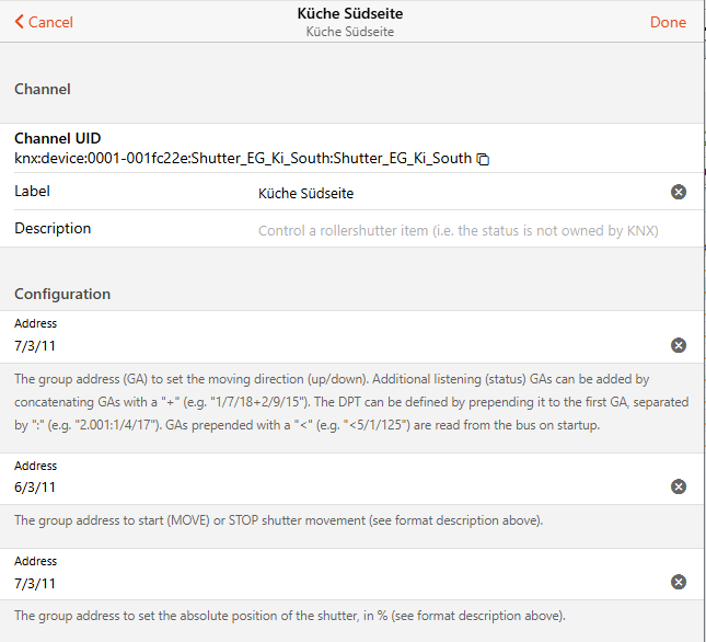

I am now trying to adopt/ crfeate the shutters into the system as well. current (1.x) setup looks like:
Rollershutter Shutter_DG_Bath “RL Bad” (DG_Bath, Shutters) {knx=" 7/3/15, 6/3/15 "}
I am struggeling now to setup the blinds within OH 4.

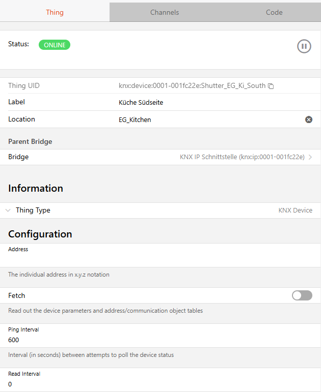

  1. KNX is connected via bridge (works for lights and heating)
  2. Thing created:
  3. Channel created:
    … while i only have those 2 addresses as per OH1.x setup and not 3. I tried different positions of the KNX adresses in the channel with no success.

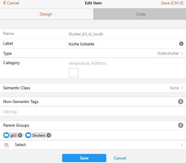

  4. Lastly item created:
Unfortunately nothing is working on the blinds. no up/ down (would be sufficent for the first try).
Can someone pls help me understand what is wrong here? Would be very much appreciated.
thanks Karsten
In a “classic” knx environment (i.e. without any visualization) the chances are high that there are no extra status GA and no GA for absolut positioning and/or absolute dimming.
Both GA 7/3/15 and 6/3/15 are for UP/DOWN and STOP command (but please be aware that there is no real STOP for shutters, but only a step command, which will lead to a short up or down move followed by a complete stop. For conventional shutters the step time is set to a very low value, so the movement maybe will be invisible.
Don’t set a GA for Position at all, you don’t have any.

Bridge knx:ip:bridge "my knx/IP Bridge" [
    ipAddress="192.168.178.22",
    localIp="192.168.178.33",
    type="TUNNEL"
 Thing device shutterREG1 "Shutter device 1" [] {
     Type rollershutter : ch1 "Küche Südseite" [ upDown="7/3/11",stopMove="6/3/11" ]
And the corresponding Item is
Rollershutter RS_EG_Kueche_Sued "Rollladen Küche Südseite" {channel="knx:device:bridge:shutterREG1:ch1"}
Please be aware that you won’t get any information about the position, other than 0 % or 100 %, depending on the last movement.
thanks - this works. Now i only need to fix dimmer :slight_smile:
