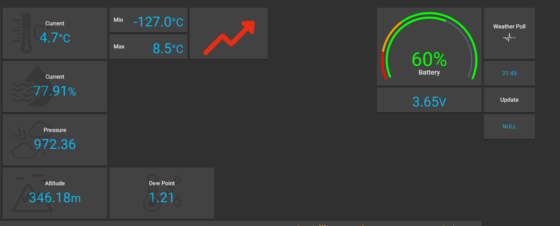

For those who wanted the code, the version last night was dodgy and causing crashdumps
In more refactoring I changed the wifi library to use only use wifi manager if no saved wifi details. The effect of this is the wifi start up time went from 2-3 seconds to 200ms!! The whole thing now runs in roughly 400ms.
I’ve hurt my battery capacity last night due to the constant crashdumps. Hoping the new, 1300% startup improvements allows me to recoup some in this miserable winter weather…
