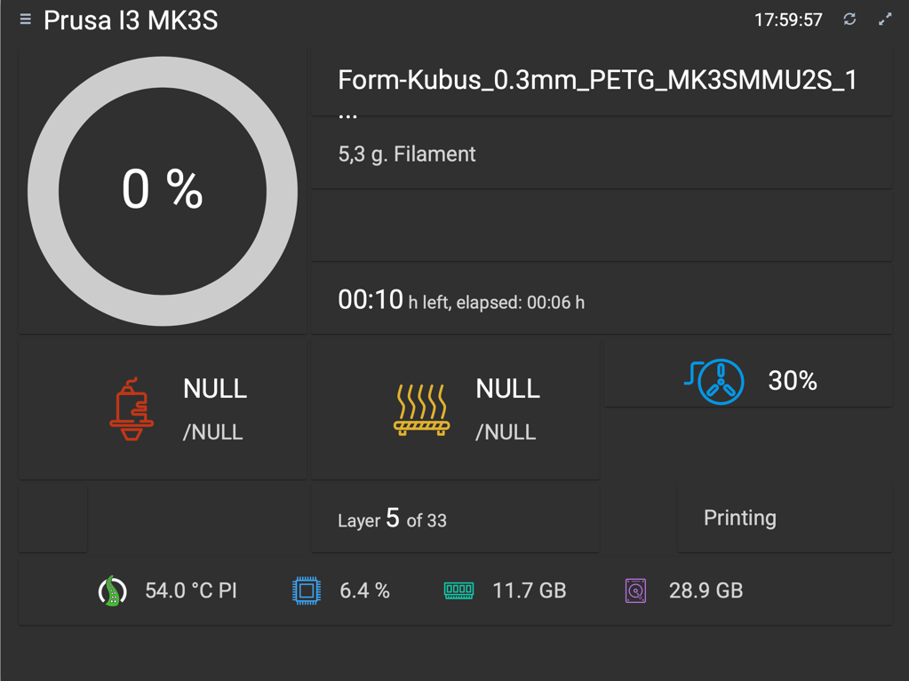

Hy,
I added a HABPanel like Octodash and expanded the MQTT thing and items.
How can I create a Template from them?
What ist the best technic for Responsive Design?

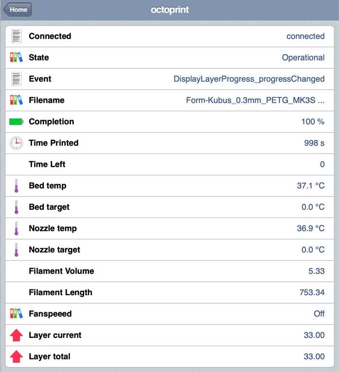

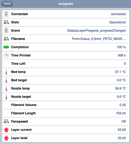

Here it the VIEW in Classic UI

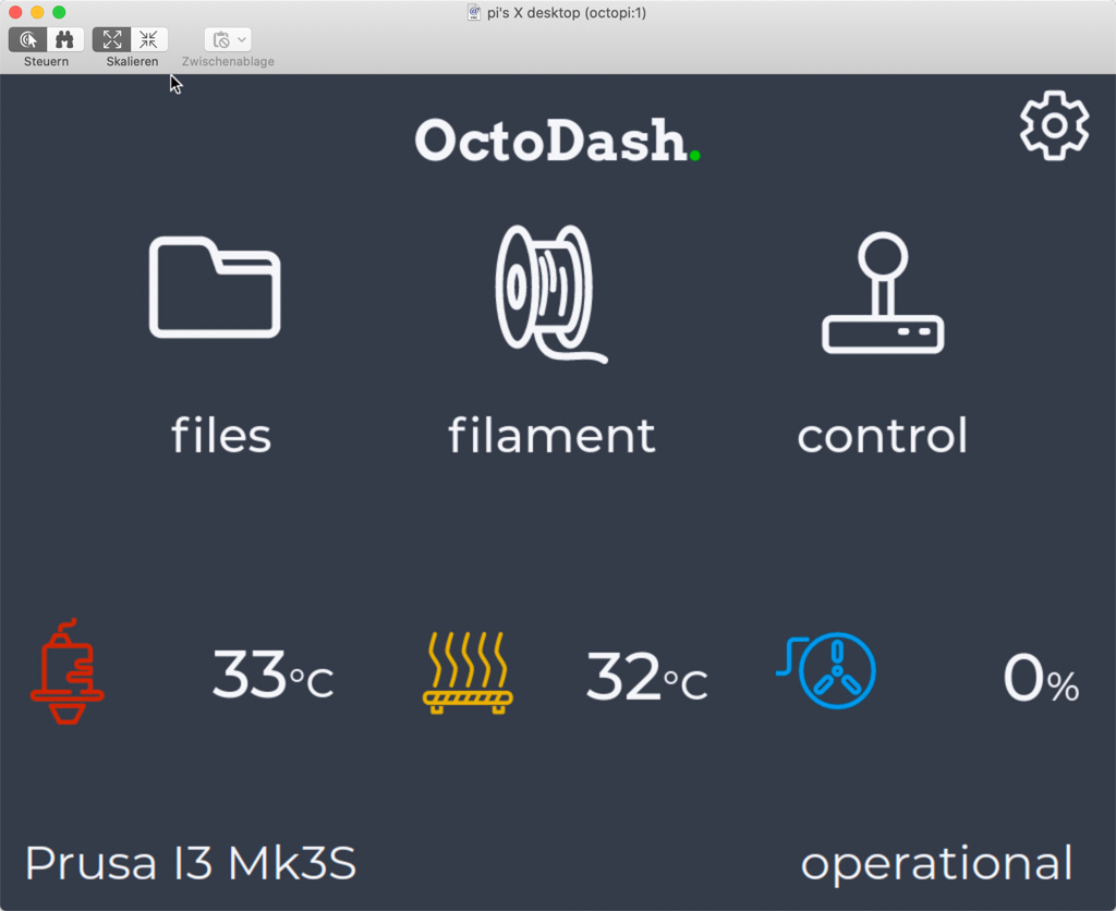

Octodash on Raspberry HyperPixel 4.0 https://www.thingiverse.com/make:727128
