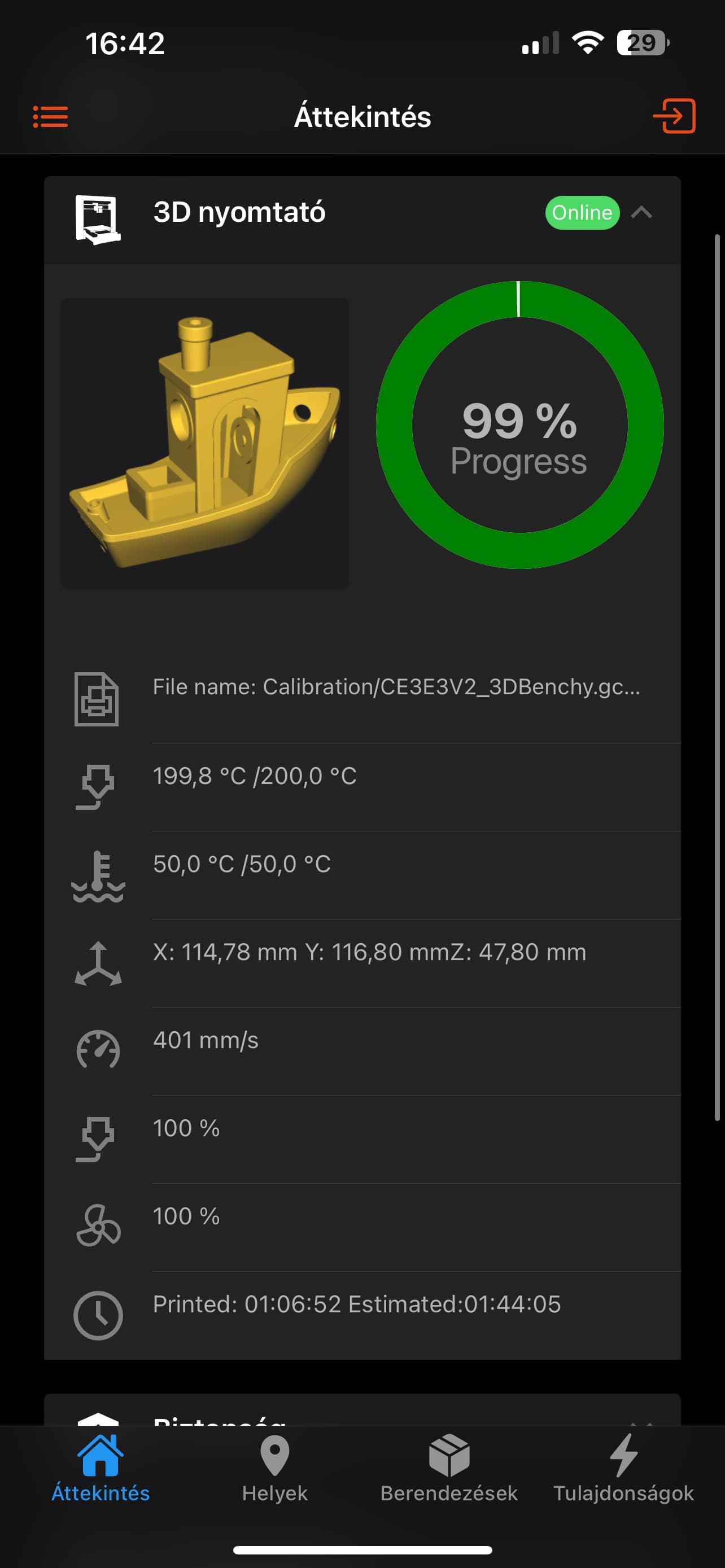

Hey everyone,
I have started to created a widget to my 3D printer and I cannot make work the visible ( in a string the state changing and I want to use the ,printing" state to show the relevant data).
Here is the code:

Here is a older picture from the widget when I started a print on klipper:

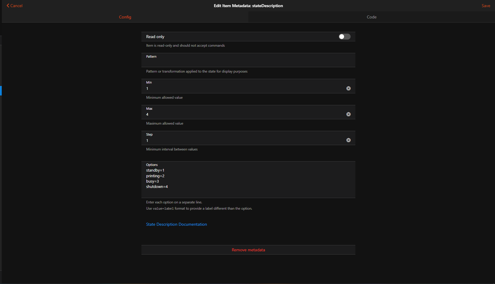

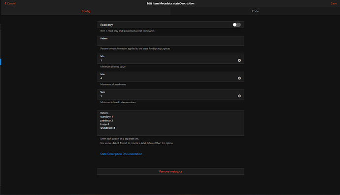

Here is the string value defined in the item state:
value: " "
  options: standby=1,printing=2,busy=3,shutdown=4
  step: "1"
  min: "1"
  max: "4"
I would like to hide the file name, the thumbnail picture, the progress gauge and the printing time when the value is not 2
Thanks for the help and advice!

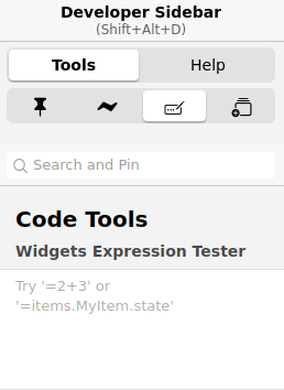

This is an excellent example of when to use the expression tester in the developer sidebar:
99% of the time when a problem like this occurs it is because the item does not have the state you are expecting. Enter the expression you are using in the visible property into the testing box and check the result to see if you get the correct true or false value. If you do not get the value you expect, then just enter an expression that returns the state of the item to see what that value really is instead of what you expect.
From what you have shown, I suspect that the problem here is that you are mixing up the displayed item values and the actual item states. If you would rather test the modified states instead of the actual state, then you have to use items.ItemNameHere.displayState.
Thanks, I understand that this tool existing, but I cannot make the visible thing to work, even if I enter the ,Standby" after the ,=items.PrinterSateItem.state === “xyz” " :smiley:
The visible property works for all components. If you are not seeing the results you expect, then issue must be one of two things: the yaml formatting or the expression. If you are not getting a yaml formatting error and the visible property is in the component’s config object, then the problem can only be the expression itself.
From what you have shown, I can only suggest that, in the widget expressions, there is usually no reason to use strict equality (===) and you’re better off with just ==. Other than that, however, because no one else has access to your system and your items, without the results of tests in the expression tester, I cannot really offer any further advice.
What is the return value of =items.PrinterSateItem.state in the expression tester? Does =items.PrinterSateItem.state == “Standby” give different results when the item state changes?
Also it might or might not be related but the options syntax is value=label so you might have it the wrong way (i.e. should be 1=standby,2=printing...).
Anyways if you’re still not sure you could also cover both cases with

(but it’s always good to know what the value is with the expression tester)
