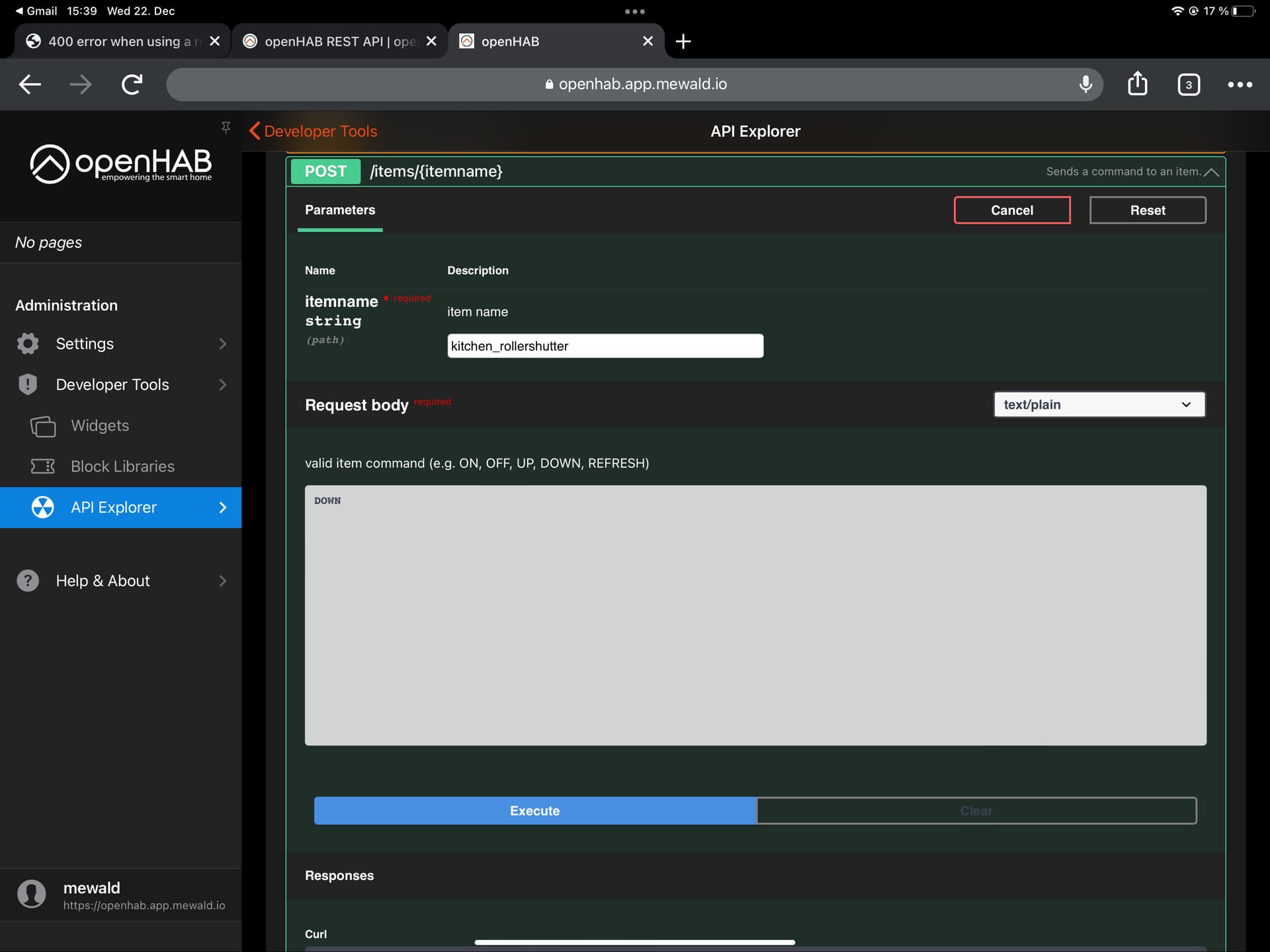

Here’s the full request as a curl. Apparently, the payload is just the text “DOWN”.
I am missing the -X POST in your curl statement. But I don’t know if curl uses POST as soon as --data-raw is part of the command. Does the access work when you use the API explorer ?
It looks like you are trying to send the DOWN command to the equipment group and not to the rollershutter point item. In that case the error is probably because the first member of that group is a dimmer item and I don’t believe DOWN is a valid command for dimmer items.
An equipment is just a regular group item with an extra semantic tag. Group items propagate whatever command they receive to all the member items, but they are not intelligent about it, there’s no filter to prevent commands from going to an incompatible object. For the semantic groups you are very often going to have too many different types of items in the group to be able to broadcast a sensible command via that group.
Typically if you want to be able to use a group to send a command to a lot of similar items at once, you will create a group just to hold those items for that purpose.
