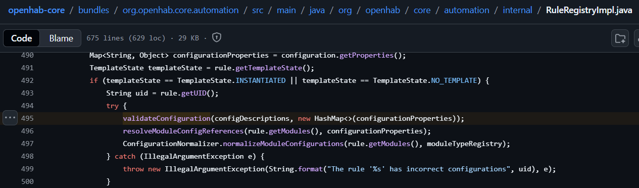

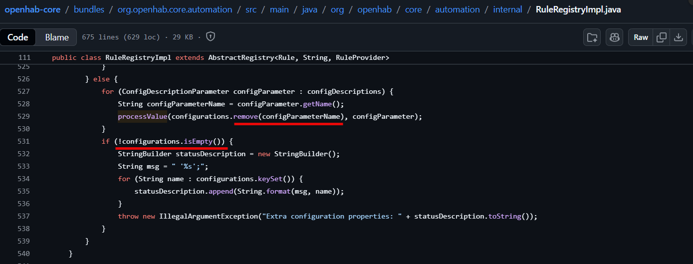

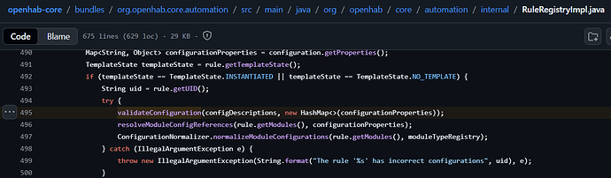

This part of the error: Extra configuration properties: ‘type’; ‘source’; comes from the RuleRegistryImpl and my best guess is that the rule configuration set in openhab-js/rules/rules.js rule.setConfiguration which includes type and source does not match a “configurationDescription” which is set in a location I cannot find for this type of rule.
My best guess: there is a configuration validation/normalization process that occurs prior to adding the rule to the rule registry and in this case the openhab-js rule provides a configuration that does not match its description. The IllegalArgumentException is just logged and the code proceeds to add the rule to the registry, so I think it doesn’t affect any actual functionality, but wanted to mention it here regardless in case I’m missing something simple.

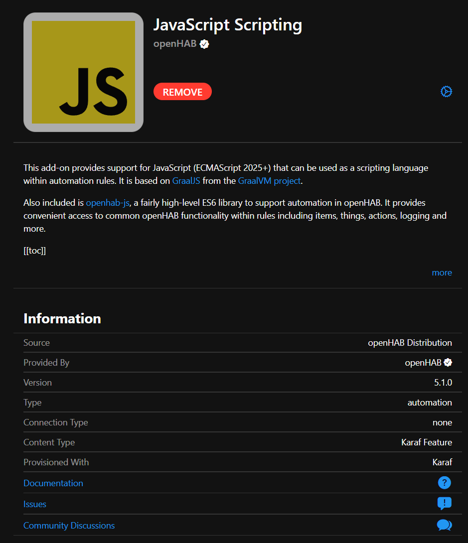

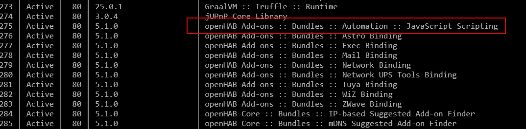

Do you have a manual install of the helper library or are you depending on the one that’s bundled with the add-on. If a manual install, is it updated to the latest?
As far as I’m aware this is using the bundled one, I haven’t done any manual installs. This is what karaf shows and what’s in the UI:

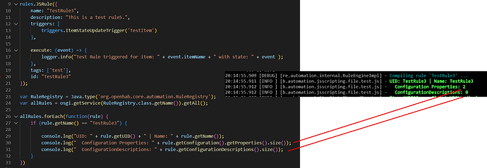

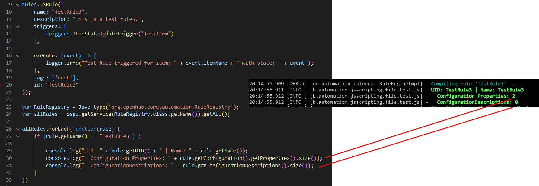

I can make a rule in the GUI and this doesn’t happen, although the GUI-based rules don’t seem to use “configuration” to store the various values.
When I inspect the RuleRegistry at runtime I see 2 Configuration Properties but zero ConfigurationDescriptions:
This appears to cut against expectations in RuleRegistryImpl.validateConfiguration() which appears to want them to match: openhab-core/bundles/org.openhab.core.automation/src/main/java/org/openhab/core/automation/internal/RuleRegistryImpl.java at 5f074e3c980aa2d65b2c71e57eb759e805b7d4d5 · openhab/openhab-core · GitHub
It looks like the author of this code (below) starts with a Map of all of the configurations and removes them as they are compared to each config description. If any are left at the end, it throws the error. I believe my code above demonstrates zero config descriptions but 2 configs for this rule, I assume that might be a lead.

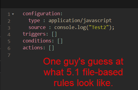

Incidentally if I add a configuration like #2 above into a GUI-based rule I get the same validation error in all versions that file-based rules are giving me in 5.1. (Note debug logging on org.openhab.core.automation is required to see it)
My guess is below on what a file-based rule looks like in 5.1 which would explain the two extra configurations type and source. Although the GUI just displays source and no other elements.
