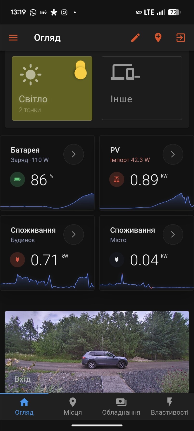

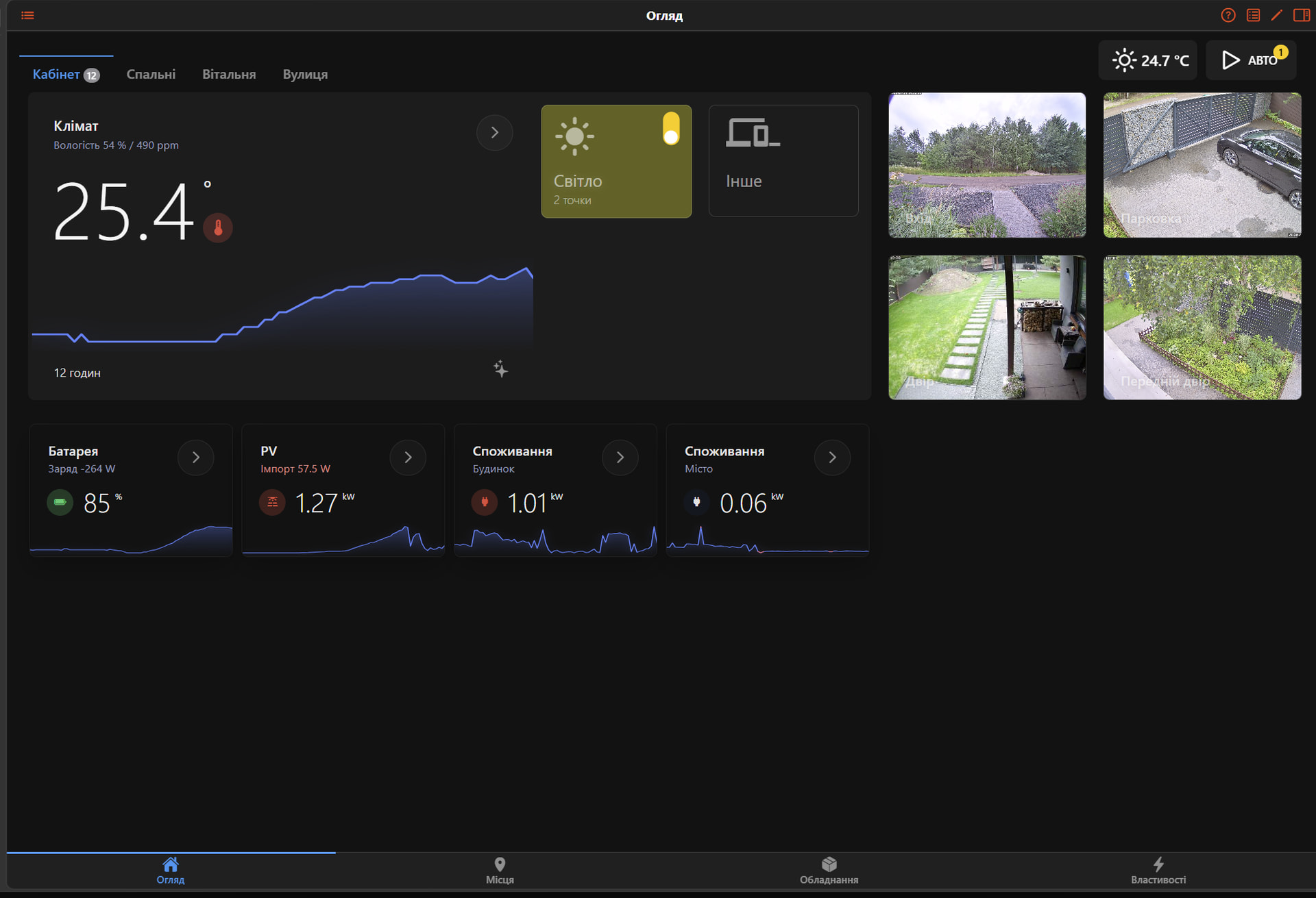

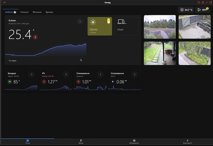

Here is what I managed to build over the weekend using Codex:
Of course, I have no illusion that openHAB will suddenly catch up with Home Assistant in popularity. However, perhaps openHAB interfaces can finally stop looking like they were “made by programmers.”

The interface I showed above is actually built as one of these bundles. It includes supporting Items, supporting rules for collecting historic JSON data and rendering SVGs, and packages everything into a single entity, even with a demo/test page included.

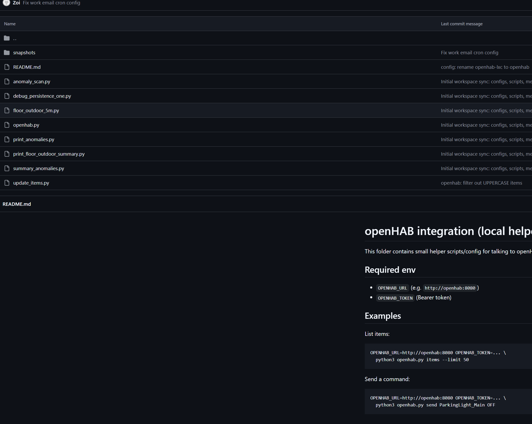

I use OpenClaw with the Codex model. On the hosts where OpenClaw and openHAB are running, I have a Tailscale network set up to provide private and secure communication between them.
Then I gave OpenClaw a prompt along the lines of: “I have a smart home running on this host with openHAB. Figure out how you can integrate with it.”
It explored the system, found the API, created a token for itself because it had access to the SSH console, reviewed the API, identified the key endpoints it needed, and that was basically it. It then created its own md files and python scripts with the relevant instructions and flows.
After some time, I noticed that it was fetching the current list of items every time. So I changed the setup so that once an hour it saves a JSON snapshot of the items into its instructions and does not query openHAB constantly.
Based on item labels and semantic metadata, it understands where everything is located and handles requests such as “turn on the light in the office,” “what is the current solar generation,” or “increase the ventilation” without any problems or unnecessary follow-up questions.
And, of course, everything is in Ukrainian, since it is my native language.
This is what the “integration” between OpenClaw and openHAB currently looks like. OpenClaw wrote it for itself while independently exploring the system. And, surprisingly, it actually works :slight_smile:
