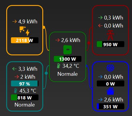

A fork of Deye Inverter Widget tailored to Huawei products and added progrssbar
Hi to Everyone,
this is a fork of Deye Inverter Widget with the following additions:
  • progressbar on power indications and battery SOC
  • tailored to Huawei Solar2000+Luna2000 variable set
  • added wallbox consumption as separate item
What you need to change to fit to your house:
on each progress bar you have to modify 3200 to your max power of each component, in my case is in Watt.
=(Number.parseFloat(items[props.itemXXXXXX].state)/3200*100)
This is required to rescale correctly progress bars, I did not pull them outside widget to avoid too may paramenter to be set being setting is usually once in a life.

                          style:
                            align-items: center
                            flex-direction: column
                            height: 90px
                            justify-content: center
                            width: 90px
                      - component: f7-block
                          style:
                            align-items: center
                            border: 2px solid green
                            border-radius: 20px
                            display: flex
                            height: 170px
                            width: 125px
                          default:
                            - component: oh-link
                                iconColor: red
                                iconF7: arrow_right
                                iconSize: 18px
                                style:
                                  font-size: 18px
                                  pointer-events: none
                                  white-space: nowrap
                                text: =items[props.itemDailyInverterPower].displayState
                            - component: oh-icon
                                color: green
                                height: 40px
                                icon: if:cbi:huawei-solar-inverter
                                style:
                                  height: 20px
                                  position: relative
                                  width: 125px
                                default:
                                  - component: f7-progressbar
                                      progress: =(Math.abs(Number.parseFloat(items[props.itemInverterPower].state))/3650*100)
                                      style:
                                        --f7-progressbar-bg-color: black
                                        --f7-progressbar-height: 100%
                                        --f7-progressbar-width: 100%
                                        --f7-theme-color: green
                                  - component: Label
                                      style:
                                        align-items: center
                                        display: flex
                                        font-size: 16px
                                        font-weight: bold
                                        height: 100%
                                        left: 0
                                        position: absolute
                                        top: 0
                                        width: 100%
                                      text: =Math.abs(Number.parseFloat(items[props.itemInverterPower].state)) + ' W'
                                iconColor: green
                                iconF7: thermometer
                                iconSize: 18px
                                style:
                                  font-size: 18px
                                  white-space: nowrap
                                text: =items[props.itemInverterTemperature].displayState
                            - component: Label
                                text: =items[props.itemInverterStatus].state
                - component: f7-col
                    style:
                      align-items: center
                      display: flex
                    default:
                      - component: f7-col
                          preserveAspectRatio: xMidYMid slice
                          style:
                            height: 390px
                            width: 20px
                          tag: svg
                          viewBox: 0 0 10 150
                          xmlns: http://www.w3.org/2000/svg
                          default:
                            - component: f7-row
                                d: M10,35 h-2 q-3,0 -3,15 t-3,15 h-2
                                fill: none
                                stroke: darkred
                                stroke-width: 2
                                tag: path
                                vector-effect: non-scaling-stroke
                            - component: f7-row
                                fill: darkred
                                r: 2
                                style:
                                  stroke-width: 4
                                tag: circle
                                visible: "=(Math.abs(Number.parseFloat(items[props.itemConsumptionFromGrid].sta\
                                  te)) < 10.0) ? false : true"
                                default:
                                  - component: f7-row
                                      calcMode: linear
                                      dur: |-
                                        =(Math.abs(Number.parseFloat(items[props.itemConsumptionFromGrid].state)) > 3000) ? '1s' :
                                         (Math.abs(Number.parseFloat(items[props.itemConsumptionFromGrid].state)) > 2000) ? '2s' :
                                         (Math.abs(Number.parseFloat(items[props.itemConsumptionFromGrid].state)) > 1500) ? '3s' :
                                         (Math.abs(Number.parseFloat(items[props.itemConsumptionFromGrid].state)) > 1000) ? '4s' :
                                         (Math.abs(Number.parseFloat(items[props.itemConsumptionFromGrid].state)) > 500) ? '6s' :
                                         (Math.abs(Number.parseFloat(items[props.itemConsumptionFromGrid].state)) > 100) ? '8s' :'16s'
                                      keyPoints: "=(Number.parseFloat(items[props.itemConsumptionFromGrid].state) > 0)
                                        ? '1;0' : '0;1'"
                                      keyTimes: 0;1
                                      repeatCount: indefinite
                                      tag: animateMotion
                                      default:
                                        - component: f7-row
                                            tag: mpath
                                            xlink:href: "#gridpath"
                            - component: f7-row
                                d: M0,85 h2 q3,0 3,15 t3,15 h2
                                fill: none
                                stroke: blue
                                stroke-width: 2
                                tag: path
                            - component: f7-row
                                fill: blue
                                r: 2
                                style:
                                  stroke-width: 4
                                tag: circle
                                visible: "=(Math.abs(Number.parseFloat(items[props.itemHomeConsumption].state))
                                default:
                                  - component: f7-row
                                      calcMode: linear
                                      dur: |-
                                        =((Number.parseFloat(items[props.itemHomeConsumption].state)) + (Number.parseFloat(items[props.itemDailyWallboxPower].state)) > 3000) ? '1s' :
                                         ((Number.parseFloat(items[props.itemHomeConsumption].state)) + (Number.parseFloat(items[props.itemDailyWallboxPower].state)) > 2000) ? '2s' :
                                         ((Number.parseFloat(items[props.itemHomeConsumption].state)) + (Number.parseFloat(items[props.itemDailyWallboxPower].state)) > 1500) ? '3s' :
                                         ((Number.parseFloat(items[props.itemHomeConsumption].state)) + (Number.parseFloat(items[props.itemDailyWallboxPower].state)) > 1000) ? '4s' :
                                         ((Number.parseFloat(items[props.itemHomeConsumption].state)) + (Number.parseFloat(items[props.itemDailyWallboxPower].state)) > 500) ? '6s' :
                                         ((Number.parseFloat(items[props.itemHomeConsumption].state)) + (Number.parseFloat(items[props.itemDailyWallboxPower].state)) > 100) ? '8s' :'16s'
                                      keyPoints: "=(Number.parseFloat(items[props.itemHomeConsumption].state) > 0) ?
                                        '0;1' : '1;0'"
                                      keyTimes: 0;1
                                      tag: animateMotion
                                      default:
                                        - component: f7-row
                                            tag: mpath
                                            xlink:href: "#loadpath"
                - component: f7-col
                    style:
                      align-items: center
                      display: flex
                    default:
                          style:
                            align-items: center
                            border: 3px solid darkred
                            border-radius: 20px
                            display: flex
                            height: 170px
                            width: 125px
                          default:
                                iconColor: green
                                iconF7: arrow_right
                                iconSize: 18px
                                style:
                                  font-size: 18px
                                  white-space: nowrap
                                text: = items[props.itemDailyProductionToGrid].displayState
                                iconColor: red
                                iconF7: arrow_left
                                iconSize: 18px
                                style:
                                  font-size: 18px
                                  white-space: nowrap
                                text: = items[props.itemDailyConsumptionFromGrid].displayState
                                color: darkred
                                height: 40px
                                icon: if:mdi:transmission-tower
                                style:
                                  height: 20px
                                  position: relative
                                  width: 125px
                                default:
                                      progress: =(Math.abs(Number.parseFloat(items[props.itemConsumptionFromGrid].state))/5000*100)
                                      style:
                                        --f7-theme-color: "=(Number.parseInt(items[props.itemConsumptionFromGrid].state)
                                          < 0) ? 'red' : 'green'"
                                  - component: Label
                                      style:
                                        align-items: center
                                        display: flex
                                        font-size: 16px
                                        font-weight: bold
                                        height: 100%
                                        left: 0
                                        position: absolute
                                        top: 0
                                        width: 100%
                                      text: =Math.abs(Number.parseFloat(items[props.itemConsumptionFromGrid].state)) +
                                        ' W'
                          style:
                            align-items: center
                            height: 20px
                            width: 90px
                          style:
                            align-items: center
                            border: 3px solid blue
                            border-radius: 20px
                            display: flex
                            height: 170px
                            width: 125px
                          default:
                                color: blue
                                height: 30px
                                icon: iconify:mdi:ev-plug-type2
                                iconColor: blue
                                iconF7: arrow_right
                                iconSize: 18px
                                style:
                                  font-size: 18px
                                  white-space: nowrap
                                text: =items[props.itemDailyWallboxEnergy].displayState
                                style:
                                  height: 20px
                                  position: relative
                                  width: 125px
                                default:
                                      progress: =(Number.parseFloat(items[props.itemDailyWallboxPower].state)/4500*100)
                                      style:
                                        --f7-theme-color: blue
                                  - component: Label
                                      style:
                                        align-items: center
                                        display: flex
                                        font-size: 16px
                                        font-weight: bold
                                        height: 100%
                                        left: 0
                                        position: absolute
                                        top: 0
                                        width: 100%
                                      text: =items[props.itemDailyWallboxPower].displayState
                                color: blue
                                height: 30px
                                icon: iconify:bi:house-fill
                                iconColor: blue
                                iconF7: arrow_right
                                iconSize: 18px
                                style:
                                  font-size: 18px
                                  white-space: nowrap
                                text: =items[props.itemDailyHomeConsumption].displayState
                                style:
                                  height: 20px
                                  position: relative
                                  width: 125px
                                default:
                                      progress: =(Number.parseFloat(items[props.itemHomeConsumption].state)/4500*100)
                                      style:
                                  - component: Label
                                      style:
                                        align-items: center
                                        display: flex
                                        font-size: 16px
                                        font-weight: bold
                                        height: 100%
                                        left: 0
                                        position: absolute
                                        top: 0
                                        width: 100%
                                      text: =items[props.itemHomeConsumption].displayState
