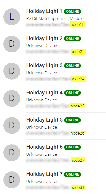

I’ve noticed during the last 6 months or so that my Z-Wave network is having issues…lights don’t come on as they should (rules do fire) and there are delays when devices are manually switched on.
What I find interesting, is that the removed Holiday Nodes still show as online, even through they are sitting in boxes on a shelf in my garage.
I would venture a guess this is why I am having Z-Wave issues…so I’m guess I should really eliminate these from the network or just leave them plugged in?
But if they are not plugged in…why does OH show them online?

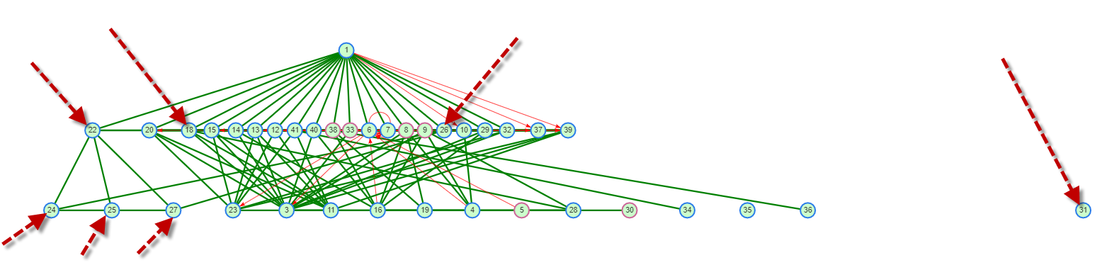

Z-Wave is a mesh network. What you see in HABmin map is the last configuration the controller and the remaining devices know in terms of which node “sees” surrounding nodes. That is used to forward messages from nodes the controller does not see directly and vica versa.
Now that you’ve taken some nodes out of the mesh, the information about the whole net is no longer accurate and some messages might not be delivered via the best connection, thus too late and maybe never be delivered if timeouts do happen.
A network heal can take care of the network information and will update the neighbors information the controller and the remaining devices have, improving your network stability. There is a setting in the controller where you can decide when it will happen or you can switch it off entirely. You may want to check this setting. A network heal is needed when the network structure is changed by adding, removing or relocating devices.

“Online” means they were fully configured. They stay fully configured even when they do not respond when switched off. The term “online” is misleading here, it does not imply the controller can still communicate with the devices.

I would like to say that it doesn’t matter, but I could be wrong! I know people have had problems with zombie nodes causing routing, but I’m not sure if the problem is “real” or not. Certainly, if you unplug a device, it will cause problems in the network immediately. Now, depending on what type of devices you have (ie how old - are they ZWave+) it (in theory!!!) ought to recover itself as there are automatic systems to search out the routes if commands fail.
If a number of devices in the network are a few years old though, this may not work well, and the network would require a heal to restore the routes - assuming all the heal commands go through ok it should restore the mesh to its former glory (and again assuming that there are still enough powered devices to form a good mesh).
