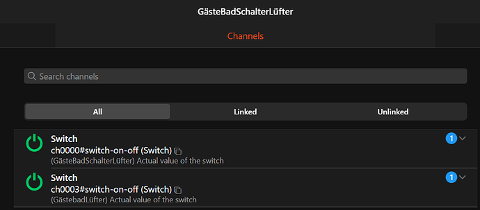

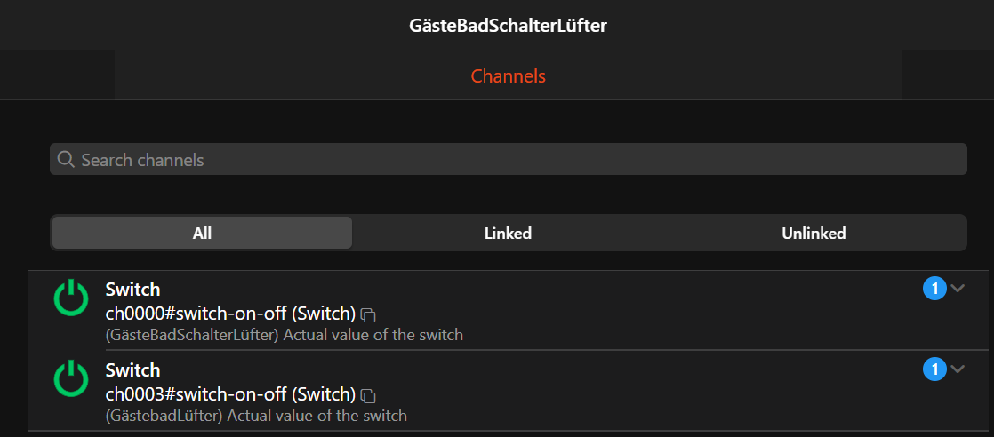

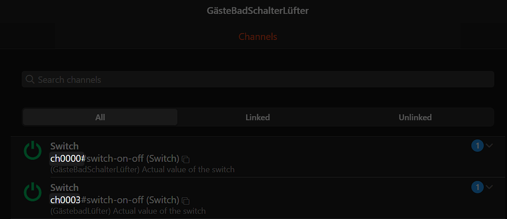

an how many channels do you have for the device? Two, like this?

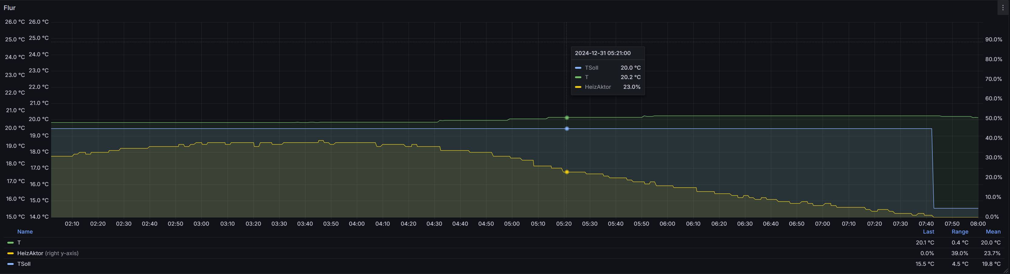

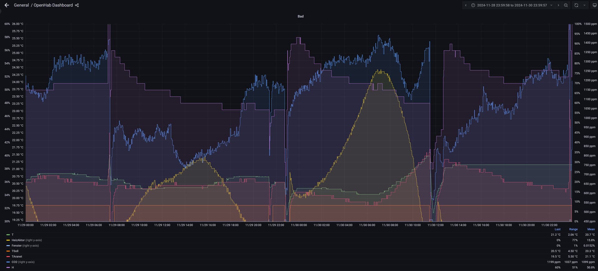

Here’s the data from my heating actuators. Could you share a chart that combines the factuating-value-heating and the measured temperature?
Currently, I’m using the version provided by @JankKeks , along with some additional bug fixes: GitHub Link to @JankKeks Fork.
Additionally, I’ve set BRIDGE_WEBSOCKET_KEEPALIVE to a value of several months. Without this change, the WebSocket connection closes after 90 seconds, right after the keep-alive message. This causes an issue where I stop receiving updates from the Busch-Jäger SysApp, although I can still send commands from OpenHAB to Busch-Jäger. Occasionally, the connection reestablishes, and OpenHAB starts receiving updates again.

Yes, my switches also have two channels. But the second probably belongs to the build in sensor(?)..
Started recording the factuating heating value today.
By the way: the new binding wich was released with the main distribution has still the same issue with the switch actuators….
No, actually the first one is the sensor, and the second one is the actuator.
  • ch000 (Sensor): Only read access in OpenHAB is relevant (e.g., to detect double clicks).
  • ch003 (Actuator): Both read and write access make sense here.

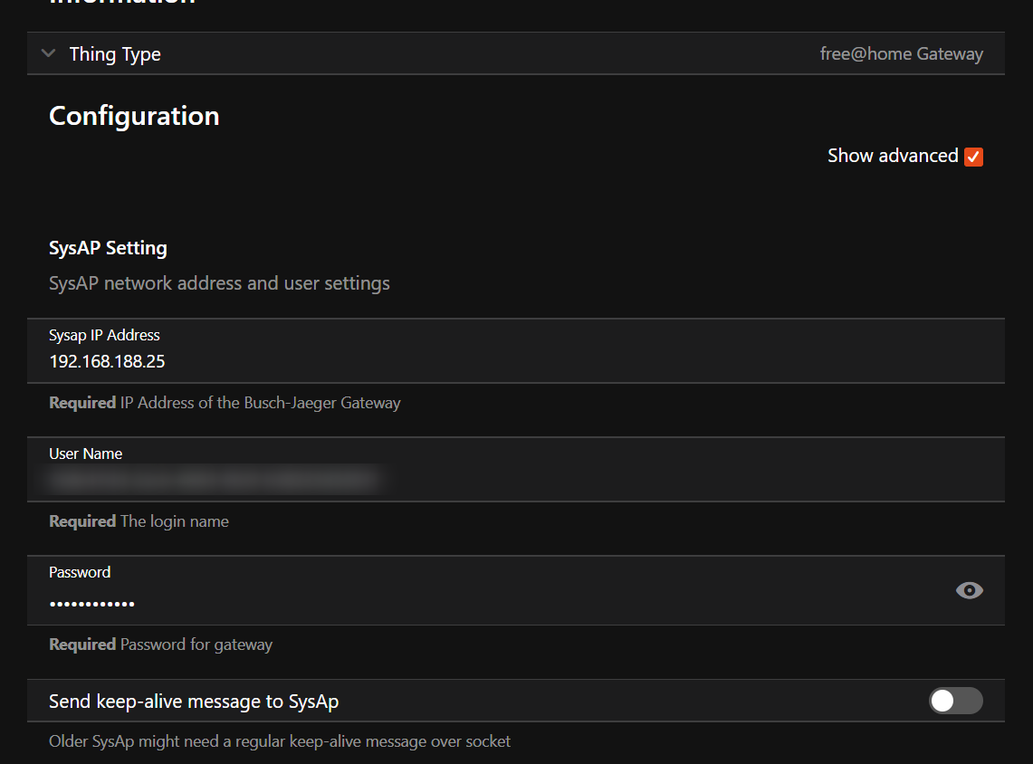

Regarding the Keep alive - I red, that it could be required to implement ping/pong for keeping the connection alive. If you have newer information it would be helpful.
no, i didn’t do any futher work on the binding. If I find some Time the next days I will try to sign the commit.
My observation was regarding WebSocket communication between SysAp and OpenHAB, that the SysAP is closing the communication channel if a keep alive message is not sent.
If the keep-alive message is not sent the values are not updating on the OpenHAB side, but the HTTP communication is still possible and the OpenHAB is able to set new values.
However this observation is based on the (very old) 3.1.1 version.
Even the newer SysAp version is not needing the keep-alive It shall be kept as an option that the binding is able to operate the older SysAp as well.
however I will update my SysAp as well.

Hi @ML1982
Thank you for the test.
if the “keep-alive” setting is “OFF”, the keep-alive message is not sent via websocket and also the timeout is not set (the timeout is kept on the default value)
Could you make a test with the “keep-alive” setting “ON”?
