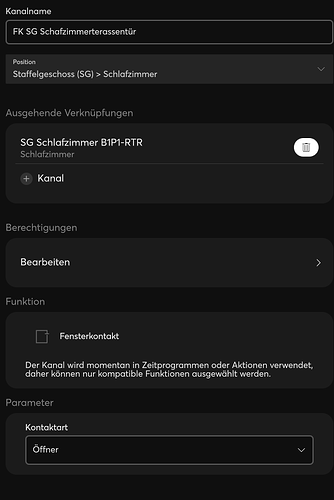

I migrated my relatively huge installation to the new free@home binding. First of all, thanks for the great work, it looks very very good so far.
However, I observe one bug. I have window contacts at home, which shall switch to ON when the window is open. In free@hoem, this is realized via the contact type opener (öffner in German). In that configuration, the channel #switch-on-off is not delivering the state from free@home. You can see the configuration in the picture, the contact type is at the bottom.
Is anyone aware of that? Do I “simply” need to use another channel or is this a bug? In that case I would open an issue in GitHub.
That fix came fast, THX!!
for those, who have the same problem, the channel is now detected as #window-door, which solved the issue.

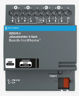

i needed a new blind actuator (Busch-Jaeger Jalousieaktor) because my old is defect.
The binding find the actuator but only the firts 2 channels ?
Is there a bug in the discovery ?
Log: Blind sensor channel - Channel FID: 0x3, not implemented yet
Thy Stephan
Hi @Stephan-Prem
to find the root cause could you send me the JSON output of your new blind actuator.
by the way this actuator is the same as you had previously or a new type?
once you send me the JSON file I will look into this iusse
Hi András,
thx for your reply.
This is the code from the new actuator in OH:
UID: freeathome:device:896533xxxx:00021704xxxx
label: f@h 4x Jalousieaktor - 5
thingTypeUID: freeathome:device
configuration:
deviceId: 00021704xxxx
bridgeUID: freeathome:gateway:896533xxxx
channels:
  • id: ch0000#move-up-down
    channelTypeUID: freeathome:shuttermovement
    label: Move Up/Down
    description: (Ⓐ Büro) Moves sunblind up and down
    configuration: {}
  • id: ch0000#adjust-up-down
    label: Adjust Up/Down
    description: (Ⓐ Büro) Stops the sunblind and to step it up/down
    configuration: {}
  • id: ch0000#set-absolute-position-blinds
    channelTypeUID: freeathome:integer
    label: Blinds Position
    description: (Ⓐ Büro) Moves the sunblinds into a specified position
    configuration: {}
  • id: ch0001#move-up-down
    label: Move Up/Down
    description: (Ⓑ Wohnzimmer) Moves sunblind up and down
    configuration: {}
  • id: ch0001#adjust-up-down
    description: (Ⓑ Wohnzimmer) Stops the sunblind and to step it up/down
    configuration: {}
  • id: ch0001#set-absolute-position-blinds
    description: (Ⓑ Wohnzimmer) Moves the sunblinds into a specified position
    configuration: {}
This is the code from the new actuator in f@h:
