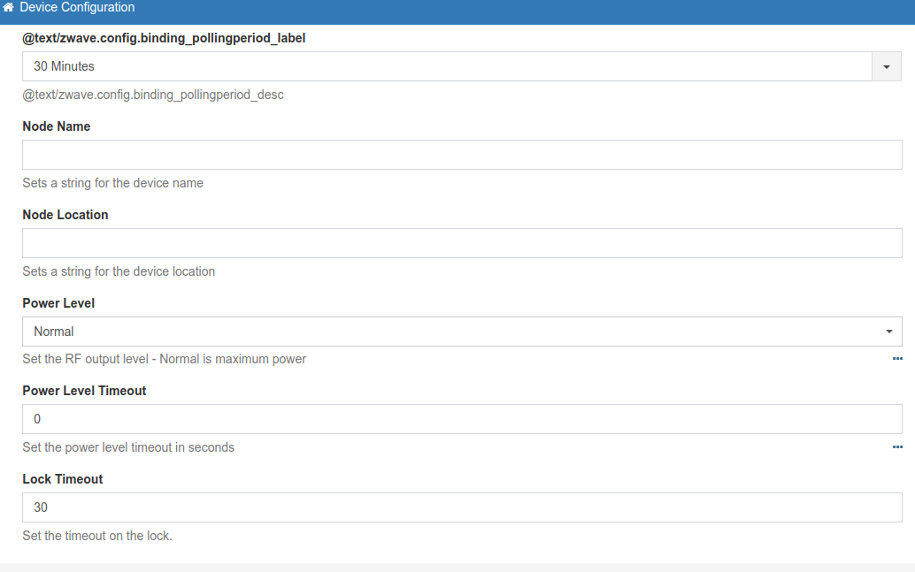

Hello,@chris
I need to ask you a question. I am in the lock when the lock, how can I operate in the OH-paper UI set the lock`s USER_CODE? Is channel? Is configuration?
User code is provided as an option in paper UI / HABmin if the device supports this command class. There is no configuration in the database - it’s handled directly in the binding.
If user code command class is supported, then the binding should detect this, and it will add a new section into HABmin to edit the list of user codes.
