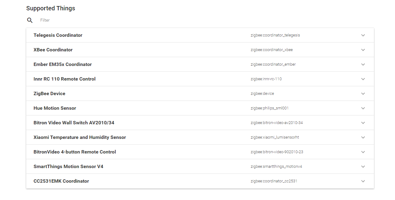

Trying this through PaperUI. If I try to do it manually I do not find any “tradfri” thing to add. Just hue motion, xiami, etc…

Shouldn’t be there the ikea bulbs as supported things?
