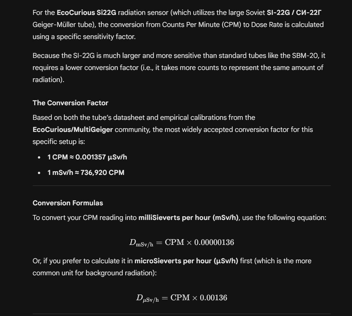

Normally for radiation Sievert is the common measurement. Asking Gemini I would apply this conversion:
For hv_values I’m honestly clueless what it means.

I convert the cpm into Sievert similar to your Gemini answer. I also compare it with other stations to get alarmed if there is something happening (increasing) in the neighbourhood (Ukraine, Poland, etc)

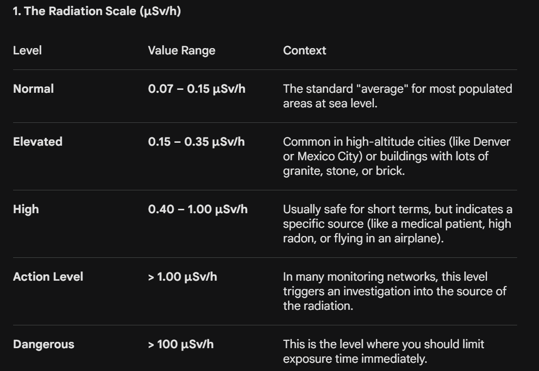

Is there also some kind categorization? Like ~30.000 is normal? 25.000 is too much drift (red/yellow flag)?
Just note I’ve no clue :smiley: . But I don’t want to report raw numbers where I don’t know the meaning behind it.
