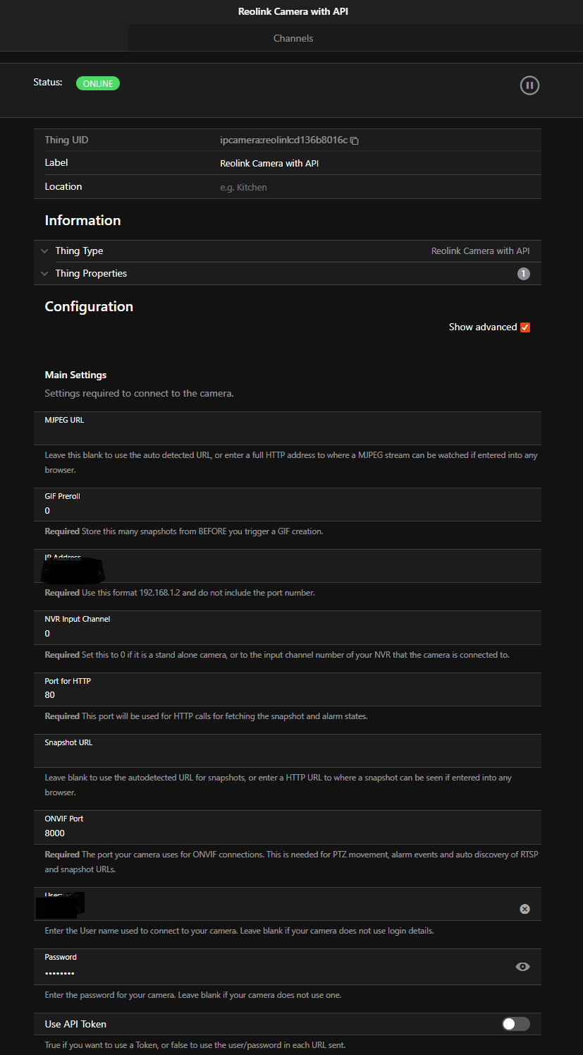

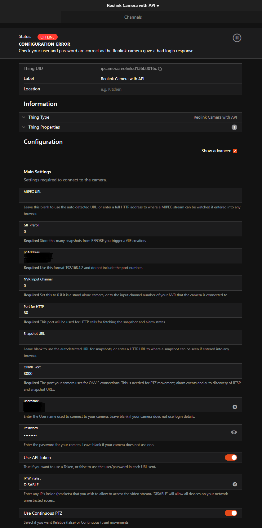

update figured it out.. when i upgraded some how the password still showed up with ****** but i deleted it and retyped it and it worked.
I just upgraded to 4.3 and now i cannot connect to my reolink doorbell with the API token enabled. I can only connect when i turn the api token off.
If i set to on i get a bad username and password.
Thanks for reporting. My theory is that the reply for the token does not come back fast enough before the camera comes online and all the REFRESH commands are sent for all the channels. Can you confirm this with the TRACE logs? The REFRESH commands are what was newly added so that openHAB asks for each channel what the setting is in the camera so that it can display the correct state and the openHAB controls match the states in the camera. Your work around of not using the tokens is probably the best way forward until we can confirm and get a fix released.
