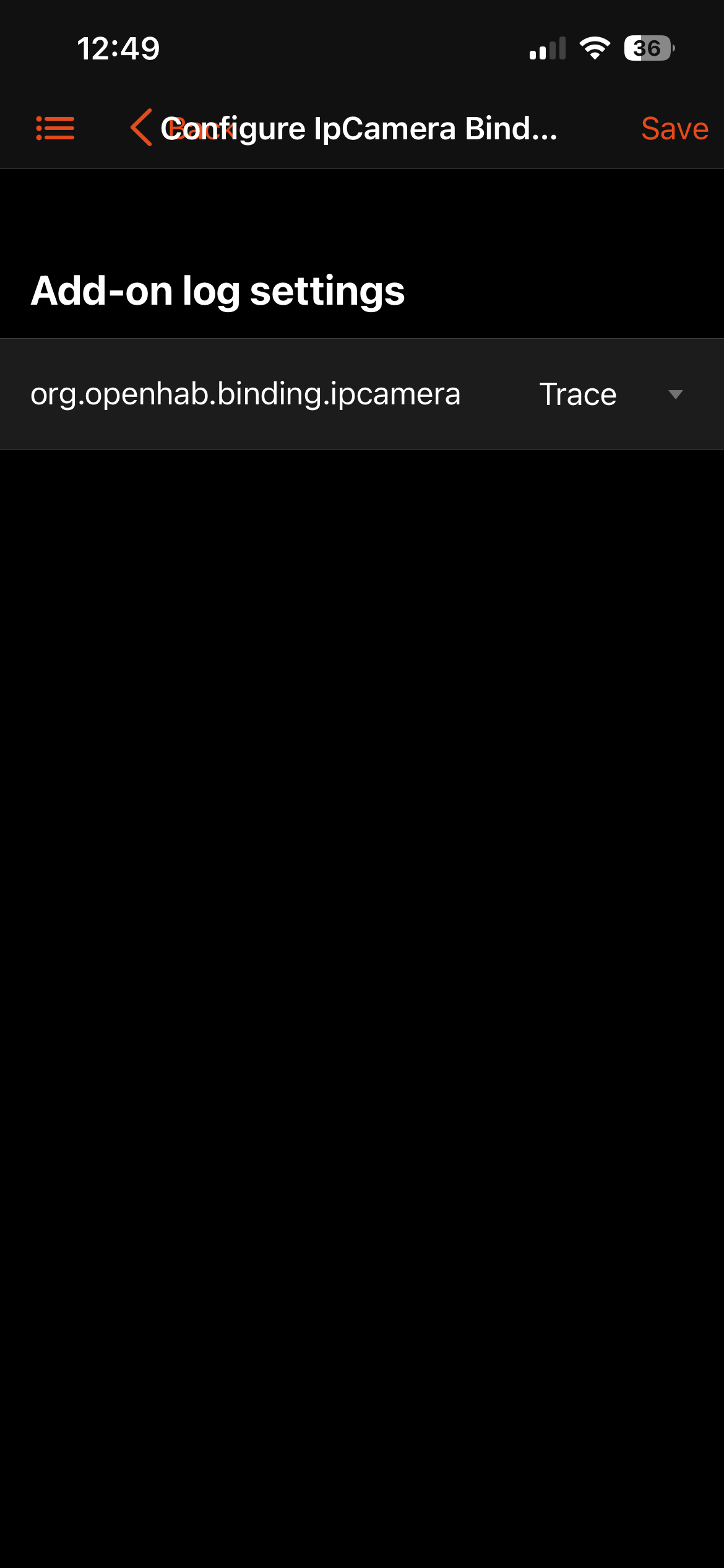

It should be pretty simple to add it if you can provide the TRACE level logs for when the crying detection is triggered and also when it is not triggered.
You should see a line like this
HTTP Result from /api.cgi?cmd=GetAiState contains \t:{xxxxxxxxxxxx}
You have to change the binding into TRACE level logging to see this.

I’m going through the logs now. With the binding in trace:
I setup a baby crying video for about 30 minutes. The camera, which btw has internet blocked, so nothing is getting out, detected the baby crying.
I got motion and person alarm on the logs, but no baby crying. Should I be looking elsewhere?
