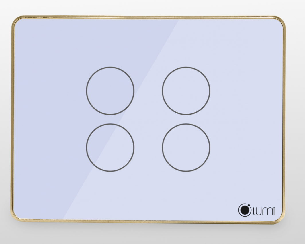

A few months ago you’ve helped me add two Unknown Zwave Devices made by Lumi to the ZWave binding database. I’m sorry to trouble you with this again, but I got two more ZWave devices made by Lumi that aren’t recognized by the ZWave binding.
Unfortunately I don’t have programing experience so I don’t know how to properly add them to the database.
Can you please help me add them to the ZWave binding device database so OpenHAB can recognize and control them?
I added both ZWave devices to the Device List on @chris website.
I hope I did it correctly. There are information bits I didn’t know how to fill, so it’s best someone else reviews what I did.

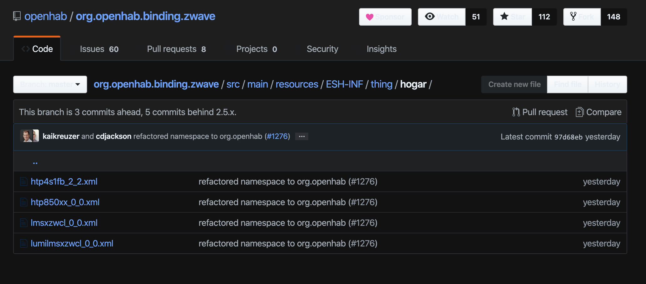

This is just someone elses database repository. It would never be merged into the main repository as database updates need to be done through the database editor.
Note that I’ve only just merged the latest database, so the build won’t be done for a few hours yet.
Sorry - you’re right. I misread this and thought it was a separate repo.
Since this is the main openhab repo, everything seen here is already included in the binding. Just be careful in future though as the master is not currently being updated as that is now OH3 and my updates are currently supporting OH 2.5 only.
For now I’ve made the decision to support 2.5.x rather than 3.0. Supporting two systems is problematic and time consuming. Currently the OH3.0 build isn’t even working, so any updates are not being built.
Until OH3.0 has some direction, and stability, I intend to continue to support the current bindings.

I see a ZWave Binding update has happened for the items listed under Hogar, but I still see only 4 items.
Were the new items added to the 4 items that were already on this list?

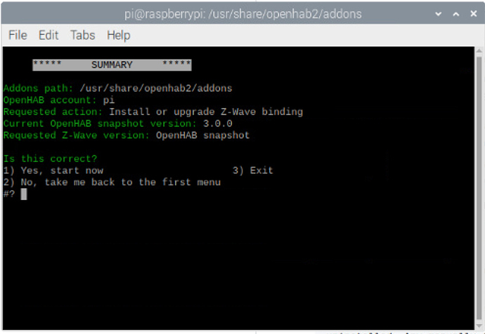

I’m trying to update the ZWave binding using @5iver’s zzManualInstaller.sh script to the new snapshot @chris created.
However, the script shows the update process will install the openHAB snapshot 3.0.0 and @chris specifically mentioned not to install the 3.0.0 snapshot.
(plese see atttached screenshot of the update message).
