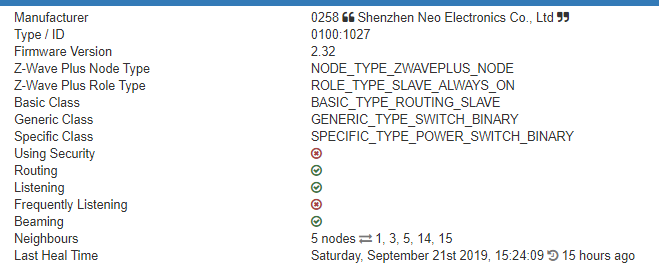

As far as I know, all are Z-Wave+. Here is the device (firmware 2.32) and the nearest 2 devices are the same model (nodes 4 & 5).

https://www.cd-jackson.com/index.php/zwave/zwave-device-database/zwave-device-list/devicesummary/401
If all nodes in the network between the device and controller are ZWave+ then the network should sort itself out without intervention (in theory at least!).
