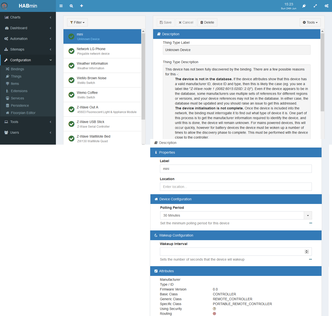

Hello. I am unable to find the place to edit parameter 250 as described above.
I have OH2.3.0, and Habmin2.3.0 addon. Do I understand correctly that I should be able to view/edit thing parameters in Habmin under Configuration, Things? If so, I merely see read-only information, of which none are parameters. :frowning:
Please advise. Thank you.
In Habmin> Configuration> Things> your minimote> Configuration Parameters, do you see 250: Secondary Controller Mode (it’s the last one)?
Be aware that this setting is not read from the minimote, so will display with the default (Group Mode) next time you look at it.
@5iver, thanks, but no, I do not have that listing! I’m confused as to why. This is all I see:
(I have a new installation of OH2.3 and Habmin2.3, running on Linux Debian jessie Raspberry Pi)
Unknown Device means your minimote is not initialized. Try waking it up (hold the join button for a few seconds).
@5iver, I did… several times. Also tried the other things this thread suggests, such as a full reset of the minimote via buttons 7 and 8 simultaneously, flashed to firmware 1.9, rebooted, etc.
Is there a simple step I missed? I’m open to all thoughts and suggestions, please. I’ve been probing around for many hours without success. Since this thread in context to OH1.8.2, I’m wondering what has changed in OH2.3 that may be contributing to my issue here. :-/

There was a recent report here about a minimote not initializing. Interesting that you are getting this with the 2.3 release zwave binding. @chris, is this possibly the same issue?
Update: I got it working. :slight_smile: No success unpairing and re-pairing while sitting in the same location the room relative to the the zwave controller. BUT if I move very close (1" away) from the Zwave controller, then unpaired and re-paired, and woke up the device, suddenly I see parameter 250 and the other jazz.
Credit to rlkoshak for realizing this. I had to read it a few times before I finally resorted to trying it. (duh me)
