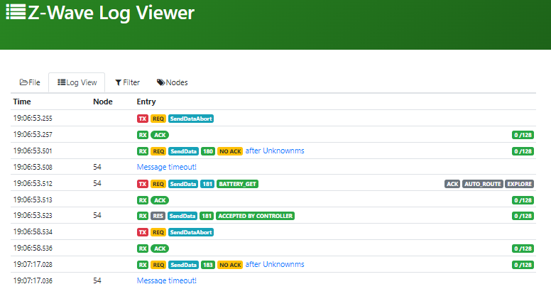

I put Zwave into debug logging mode and came up with these snippets.
Any ideas?
thanks in advance for the help!
Multisensor logs.txt (11.7 KB)
Hard to tell anything from that snippet, except the device appears to be not communicating with the controller. (No Ack). Using the log viewer
