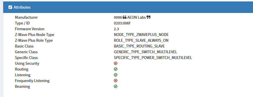

Hi All
The database confirms its supported, the device details below:
Im running this version of the ZWave binding which is very recent. Ive tried adding/deleting the thing. Any suggestions? Thanks!

What is the date the entry was added/changed in the database (itâs at the bottom of the page). Is your recent version of OH more recent than that date? If I understand the timestamp, that version of the binding is from almost two months ago.

They are Aeotec Nano Dimmer units. Not battery operated.
last updated by @Bruce_Osborne on 6th October.
It looks like 0203:0006f isnt in that list actuallyâŠif im reading it right.

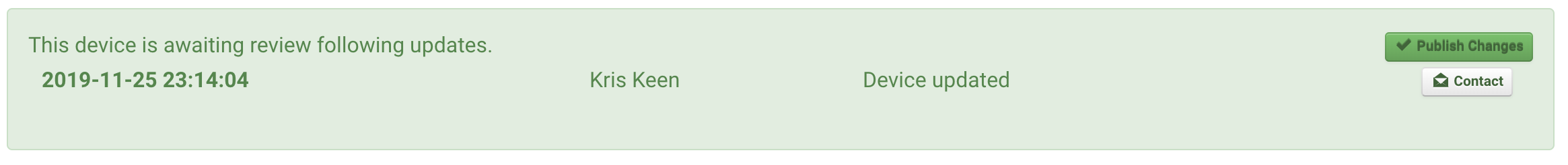

Ive just added another device ID to the database entry @chris , i believe thatâs all i need to do
XML is here
ZW111.txt (12.7 KB)
Likely that version does not have the 6th October update unless you caught the database export just right. It is normally exported once or twice a week.
dastrix80
(Kris K)
November 25, 2019, 11:45pm
6
Cool, my device id wasnât listed though so Iâve added it. I assume Iâve done it right Bruce?
It looks good to me.
We need to wait until it is reviewed, the database exported to GitHub, and then for the snapshot build to get it.

Did you request a review of your changes? It doesnât seem so -:
If you donât do this, we probably will miss your request.
