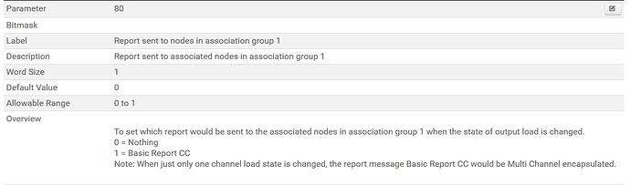

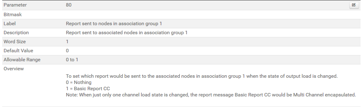

Did you try setting parameter 80 to 1?
Yes parameter 80 is at 1.
I noticed this discussion was continued in a new topic.
Long story short, the device needs a firmware update, that you cannot perform by yourself.
