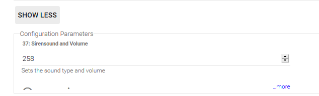

hi,
I just rechecked the config site in PaperUI for that Siren. something has changed, I don`t know when and how but it is now possible to change the siren sound and volume:
thanks to @kleintody to remind me to that Siren. my plan was to use the Siren, beside its general intention to be an Alarmsignal, to also act as doorbell when I am working behind the house where I can´t hear the indoor doorbell. for that usecase I wanted to change the type of sound and lower the volume to a “normal” value. I´ll check if I can use rules to change the properties of a device via the zwave binding…

@powerpolly: Thank you for that information. What did you do? Did you update your whole openhab installation?

most probably yes, I started with 2.2 (and had that Siren from the beginning) and somewhen switched to 2.3…
OK. I can acknowledge this.
I have also an OpenHab 2.2 installed, which showed the same problem.
I didn’t want to uprgade the whole system right now, but just tried a newer version of the Z-Wave binding. With the current version 2.4, the UI is fixed.
