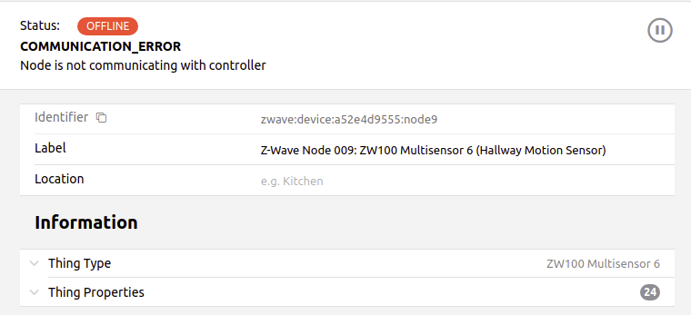

I have an Aeotec MS-6 sensor that frequently gets marked as OFFLINE in OH3
[ab.event.ThingStatusInfoChangedEvent] - Thing 'zwave:device:a52e4d9555:node9' changed from ONLINE to OFFLINE (COMMUNICATION_ERROR): Node is not communicating with controller
[ab.event.ThingStatusInfoChangedEvent] - Thing 'zwave:device:a52e4d9555:node9' changed from OFFLINE (COMMUNICATION_ERROR): Node is not communicating with controller to ONLINE
It seems that the expected time between communications is less than the actual.

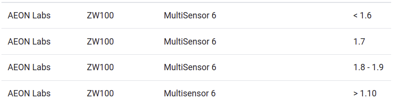

This should not be happening for a battery device. I noticed in the Zwave DB several versions of the device. Do you know what one you have? On one version there is a parameter 9 that talks about USB power/awake. If the binding thinks the device should be awake all the time that could be the issue.

Which appears to match 4 items with different FW versions:

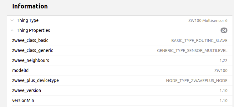

I’m not exactly sure how to tell what FW version is on board this device but OH reports this 1.10. What I’m not sure of is it that means that it is assuming that number and using that DB entry or if that was parsed from the device.

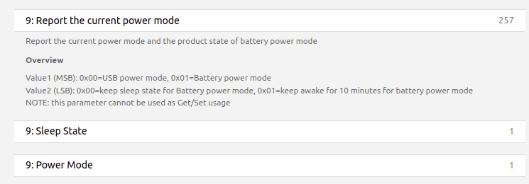

For config item #9 that is reported as 257 dec or 100000001 bin. Apparently the MSB is the power mode and 1 = battery mode, so that is correct. However the LSB is sleep state and it it set to 1 so it is supposed to keep awake for 10 mins for battery mode. This seems incorrect

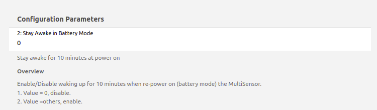

I noticed that the stay awake in battery mode is configurable in parameter 2:
However that appears to already be set to 0.

I would go with the 1.10 version since that is what OH reports.
Also it seems parameter 9 is correct for a battery device. (Could try set the power mode to 0 on parameter 9, but it seems it is set to 0 on parameter 2). So the bad news is that is likely not causing the offline/online problem.
