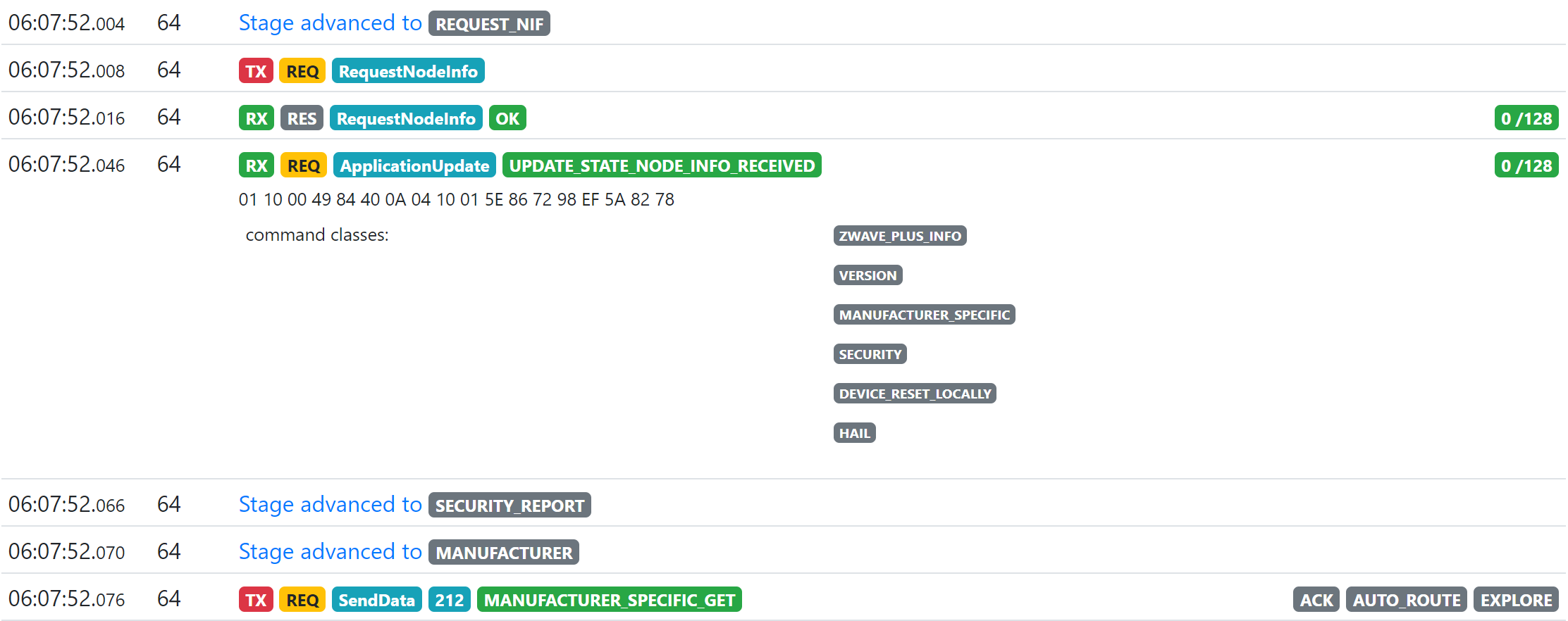

Indeed, using the “Reintialize the Device” function, this command class is not included in UPDATE_STATE_NODE_INFO_RECEIVED:

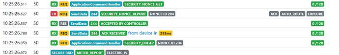

But device was included in secure mode and does encrypt:

Exactly the same problem occurred again, on the same device: the device is still working as securely included (NONCES are exchanged), but is treated as non-secure (zwave_secure is false).
Question: how does openHAB determine whether a device is using “secure” data exchange? By looking if the “SECURITY” command class is in the NIF? In this case this command class is in the NIF.

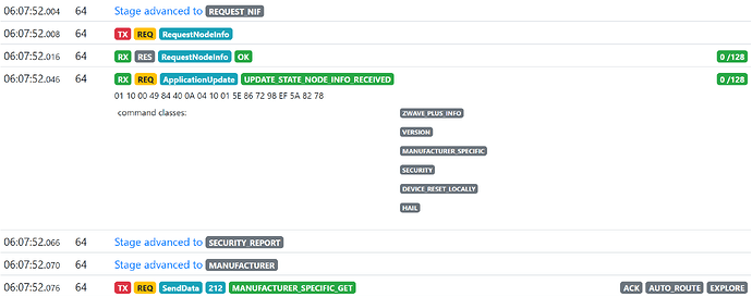

After a “Reintialise the Device” the NIF contains the SECURITY command class:
@chris: why did openHAB change zwave_secure to false for this device (the device was working nicely previously)? Any specific information that the zwave binding is looking at?
