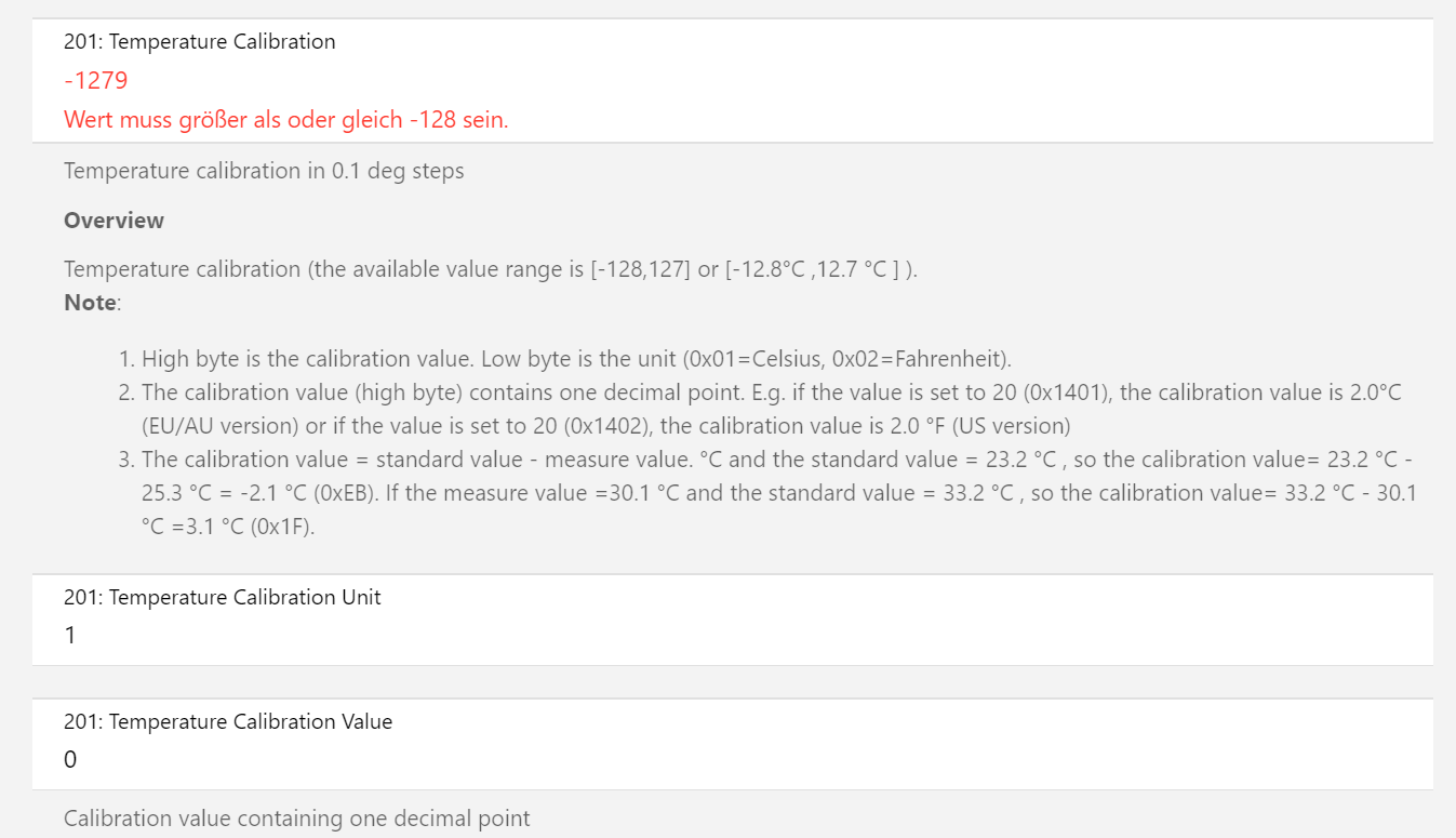

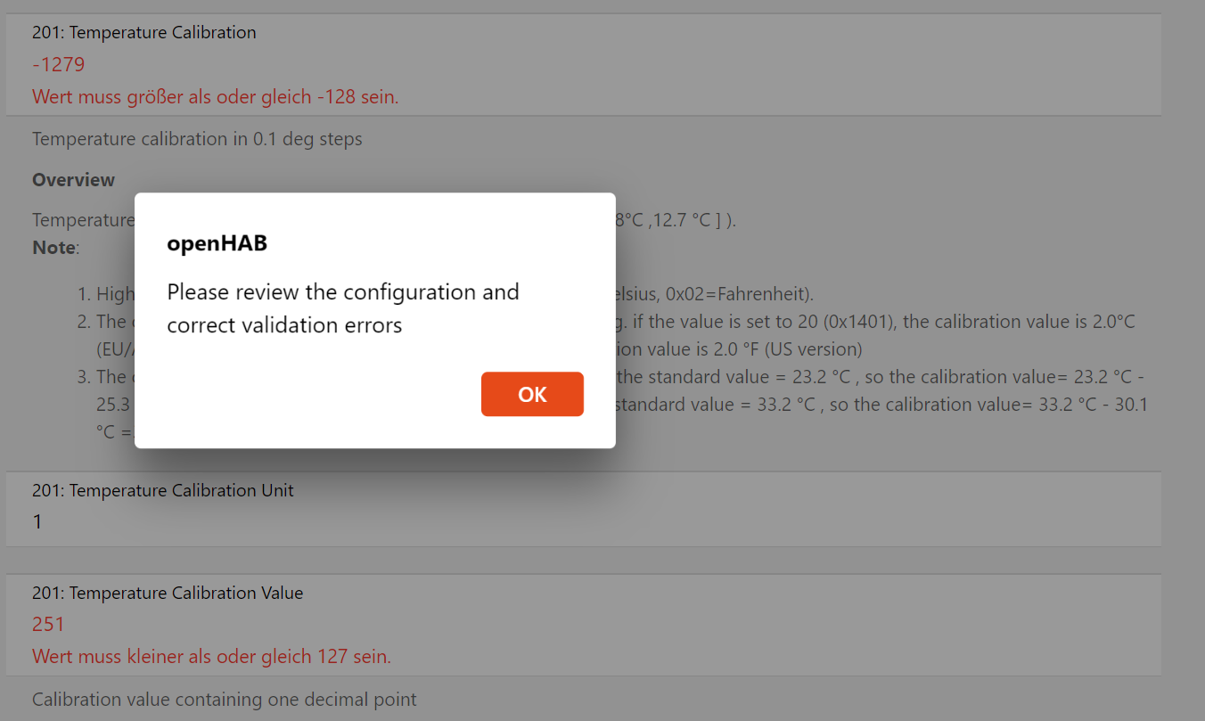

(in English: “251 - the value must be smaller or equal to 127”)
When I change to value from 251 to e.g. 1 and press “Save”, then the Web UI does not complain, but the openhab logfile shows:

Just did a check (have that device myself): the two halves of the parameter are seperated in the database, meaning one can set them independently in the GUI. I did two tests, one with a valid unit and another with an invalid unit and in both cases I get the same message (in events.log, not in openhab.log):
And the GUI checks the value for the offset correctly. If one changes it with the up/down arrows, the value cannot be changed into the invalid areas, that can only be done by entering the value manually but will result in an error message as described by Gert.

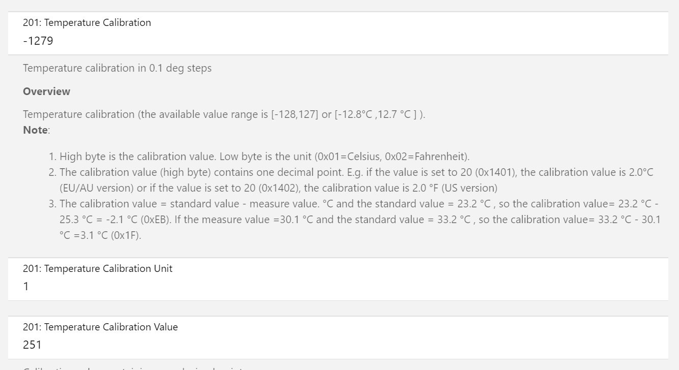

Just to be sure that I get the right understanding, please let me try to come back on the 251 value: when I click on the device in the Web UI, then the following is shown in the “Thing” tab:
When after this I replace the 251 for “Temperature Calibration Value” with 0 (or other values) the error appears and no further action is accomplished:

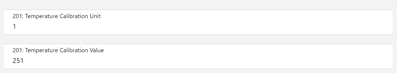

Gert, is your screenshot of the parameter 201 in any form cut or is is complete? If it is complete I see a difference to my setup: Both fields show up and down arrows to adjust the values. These seem to be missing in your case. So we have a difference:

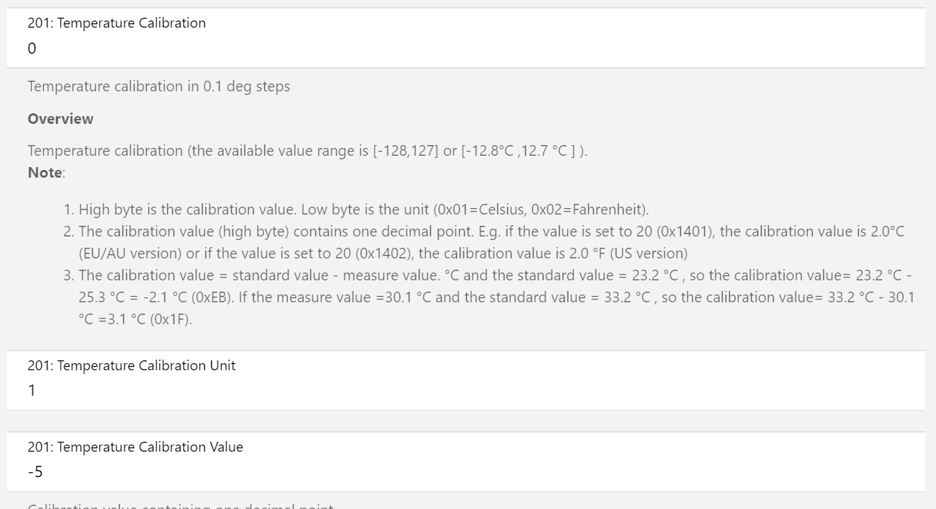

Step 1: set “Temperature Calibration Value” to 0. Then press “Save” and wait till the “Pending” disappears (for me sometimes I have to click to another thing and back to get the “Pending” updated).
Step 2: set “Temperature Calibration Value” to a negative value, e.g. -5. Then press “Save” wait till the “Pending” disappears (again for me sometimes I have to click to another thing and back to get the “Pending” updated):

-> there is a short message “Thing updated” in a black box in the left bottom corner -> the -1279 and the 251 appear

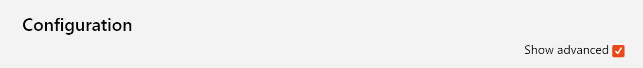

My ZW100 are powered with the USB option instead of batteries. But there is a difference between your screenshots and mine: yours show three fields for parameter 201 where mine only show two (which I think should be the correct way so noone is confused with the combined field). I’ve tested it with PaleMoon brwoser and with Firefox, the screenshot shows the Firefox view:

I followed your step by step test in my setup to reproduce the outcome but WITHOUT the “advanced option” being active as I wanted to eliminate a possible influence from the third field. And as you wrote, in step 3 the value “251” is shown instead of “-5”. Which leads me to suspect that somewhere in the chain negative values are calculated/represented in a diffent way than expected in the GUI.
