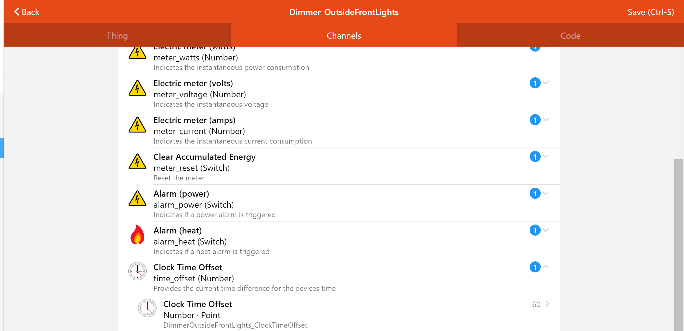

Is anybody able to advise how to change the “Clock Time Offset” item that’s part of an Aeotect Nano Dimmer (ZW111)? My setup seems to have a value of 60, which seems to trigger my rules early. The rule is set to switch the light off at 23:00, but it triggers at 22:00.
I don’t think that this is a problem with the time offset then - that is 1 hour early. The 60 seconds difference in the time really won’t make that big of a difference.

The one thing that may be the culprit is the changing of my timezone after setting up my Things (from Berlin->London). I wonder if I need to remove the item and re-create it within the new timezone? I can confirm that I have done a reboot or two since then.
This item will keep the time on the device set to within X seconds of the time on your computer. So if you computer time is out by 1 hour, then so will the device time. If you change the computer time, the device time ought to update as it will be more than X seconds out (where X seems to be 60 seconds).
