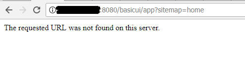

After reboot RPI - [ERROR] [.service.internal.HttpServiceStarted]
I have seen, that in netstat -lptn already exists the IP from PI and :8080…
Unfortunately, I have only found this forum post Change Port Number afterwards, where it is described that you should try to change the port to :8090 in nano / etc / default / openhab2…
After that it worked.
