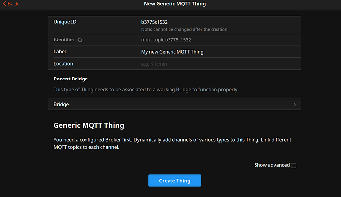

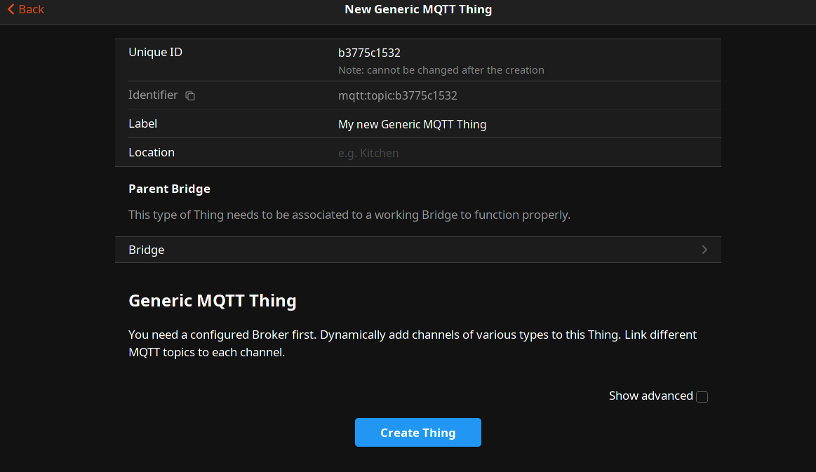

Now in the mask of the new generic mqtt thing I can’t select the parent bridge anymore.
When I click on the “Bridge” field nothing happens.
Any suggestions what I can do ?
Just to check: after you click the Bridge field, nothing appears at the bottom of your webpage? If I remember correctly it’s not like a normal list selection field that you might be used to from other websites - it appears at the bottom of the page.
This is correct: nothing happens. I checked this just again.
Neither in the middle nor at the bottom (or somewhere else) of the page.
btw: When I click on the “Show advanced” checkbox the additional settings are shown.
So it is clear, not the whole page is freezed, but the “parent bridge” field is.

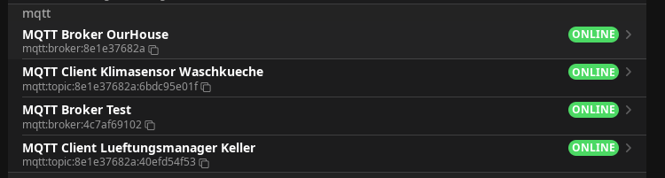

The are my things until yesterday (the second broker is from today and only for testing this problem):
