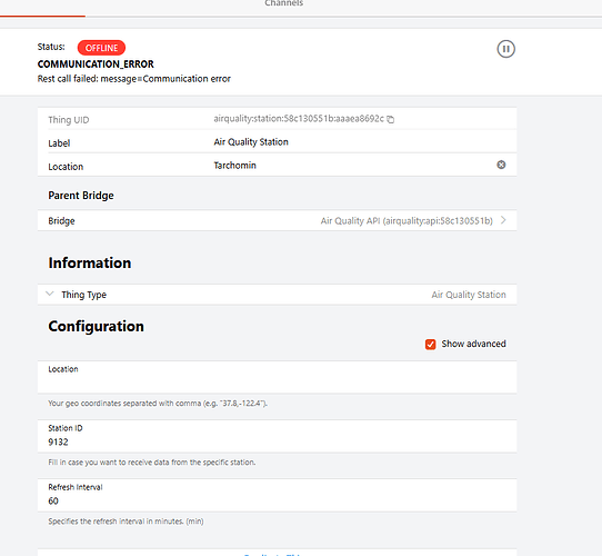

Air Quality Binding - COMMUNICATION_ERROR Rest call failed: message=Communication error
I cannot get data reading from this binding.
Air Quality APi Thing is online, API key is working.
But Air Quality Station Thing has such error: COMMUNICATION_ERROR Rest call failed: message=Communication error
I tried several different configuration of thing and error is the same. At that moment for example I have such configuration:
and is not workig, at log I see:
