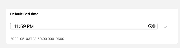

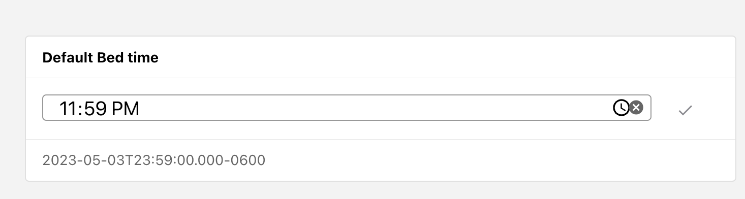

Use a DateTime Item.
Then create “default X widget” metadata using an input widget and set the “type” to “time”.
For example:
value: oh-input-card
  outline: true
  clearButton: true
  inputmode: text
  footer: =items.Default_Bed.displayState
  placeholder: hh:mm:ss
  calendarParams:
    dateFormat:
      hour: numeric
      minute: numeric
    timePicker: true
  title: Default Bed time
  type: time
  sendButton: true

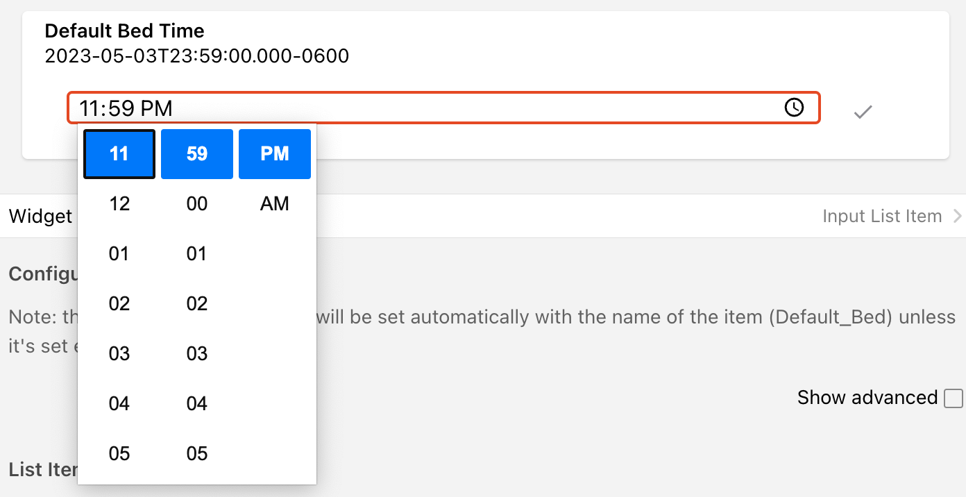

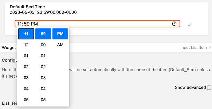

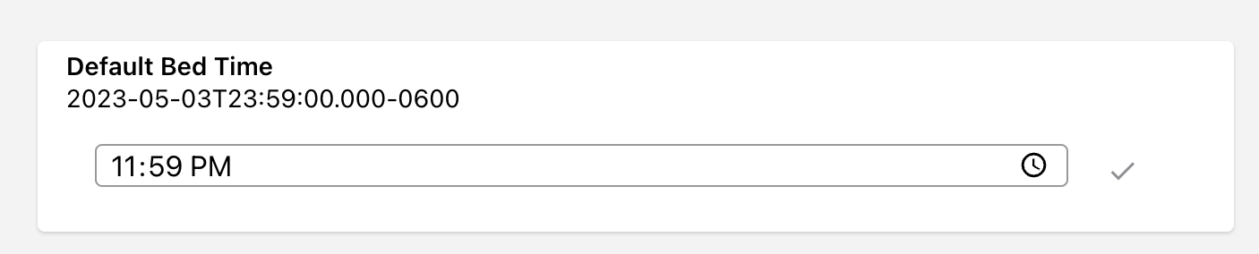

or as a List Item card:
value: oh-input-item
  outline: true
  inputmode: text
  subtitle: =items["Default_Bed"].state
  placeholder: =items[props.item].state
  title: Default Bed Time
  type: time
  sendButton: true
These both will give a nice time picker widget when clicked on.
