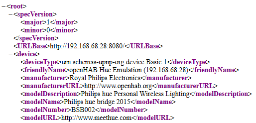

When I open the descriptions.xml, I get:

Reachability test
|URL|Responds?|Ours?|
|http://192.168.68.28:8080/description.xml|no|no|
|http://192.168.68.28/description.xml|no|no|
When starting discovery:
2020-04-20 19:53:45.950 [INFO ] [io.hueemulation.internal.ConfigStore] - Using discovery ip 192.168.68.28
2020-04-20 19:53:45.955 [INFO ] [io.hueemulation.internal.ConfigStore] - Hue Emulation pairing enabled for 60s
2020-04-20 19:53:46.296 [DEBUG] [ueemulation.internal.upnp.UpnpServer] - Self test fail on http://192.168.68.28/description.xml: java.net.ConnectException: Connection refused (Conne$
2020-04-20 19:53:46.330 [DEBUG] [l.upnp.HueEmulationConfigWithRuntime] - Cannot restart thread
