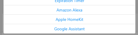

openHAB doesn’t know which devices to expose to Alexa until you tell it which ones to expose. That’s as simple as going to the item’s page in MainUI and adding Alexa metadata. Then, if your cloud is set up properly, you should be able to find the devices in Alexa.

Adding the Alexa metadata was the “missing link” and I don’t think I could have found that solution on my own.
