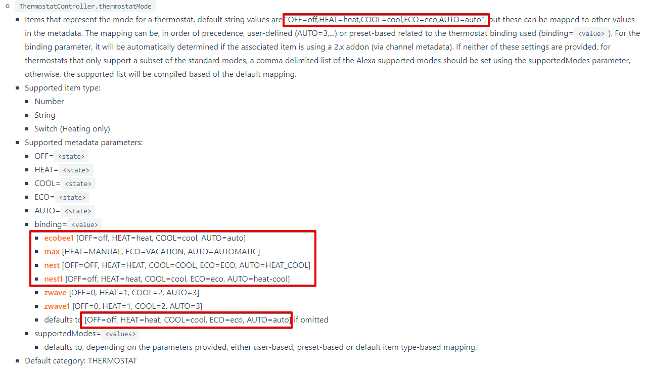

I try to integrate my custom Thermostat.
This item config works:
String  Therm_Manual  "Modus überschrieben" <thermostat>      (Thermostat) {alexa="ThermostatController.thermostatMode" [OFF=0,HEAT=1,COOL=2,AUTO=3] }
But I need this:
String  Therm_Manual  "Modus überschrieben" <thermostat>      (Thermostat) {alexa="ThermostatController.thermostatMode" [OFF=OFF,HEAT=ON,AUTO=AUTO] }
and then get this error:
2019-08-25 23:50:10.582 [WARN ] [el.core.internal.ModelRepositoryImpl] - Configuration model 'thermostat.items' has errors, therefore ignoring it: [5,126]: Number expected.
[5,135]: Number expected.
[5,143]: Number expected.
My sitemap uses this values and works:
Selection   item=Therm_Manual mappings=[AUTO="automatisch", ON="Normalbetrieb", OFF="Absenkbetrieb"]
Is there an issue with the alexa skill or am I doing something wrong?
You need to make sure to quote the parameter setting string-typed values OFF="OFF",HEAT="ON",AUTO="AUTO".
Also, make sure that your Thermostat group is set as an endpoint alexa="Endpoint.Thermostat", if not already done.

Hopefully that covers what you want to asee, if not please ask.
All rooms will answer correctly if I ask “Alexa, what is the current thermostat”.
Paul
Great.
No error this time. :+1:
String  Therm_Manual  "Modus überschrieben" <thermostat>      (Thermostat) {alexa="ThermostatController.thermostatMode" [OFF="OFF",HEAT="ON",AUTO="AUTO"] }
I guess the documentation needs an update then.
