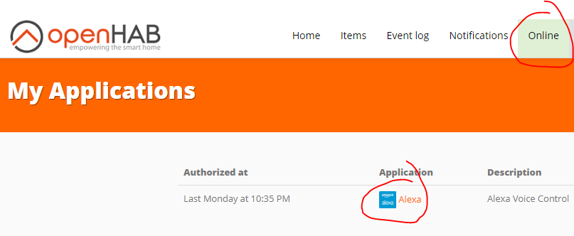

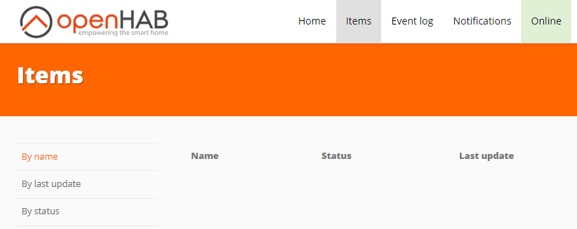

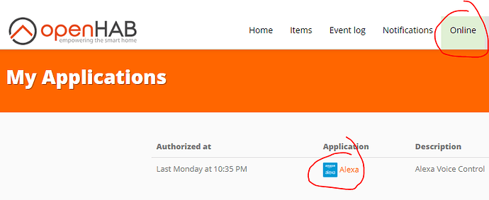

I’ve linked my local server to the myopenhab account and it shows as online there and I can see my hab panels from myopenhab, so I guess this part is good.
I’ve also linked my Alexa, so this looks good too;

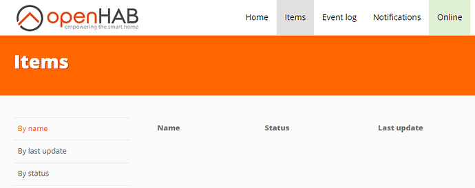

But I don’t see any items on myopenhab, should I?
And Alexa doesn’t seem to know any of my deivces…

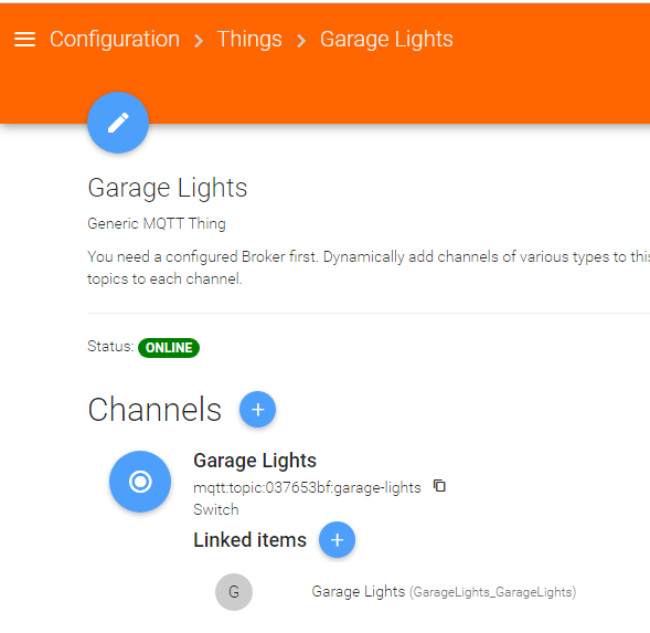

For the following example PaperUI switch over mqtt, what should the item file look like so Alexa can see it?
All my items are mostly mttq ones. Most switches, a couple of dimmers and a thermostat to read, all mttq.
I think if I can get just a couple of example Items definitions to work, I’ll be sorted.
You can get all this information in the Alexa skill documentation.
Switch GarageLights "Garage Lights" {alexa="Switchable", channel="mqtt:topic:037653bf:garage-lights"}
Thank you for that. I can see how that works for switches now, that probably covers a lot of my things.
So, I need to remove my items from PaperUI and add them in config files, really to avoid duplication?

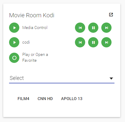

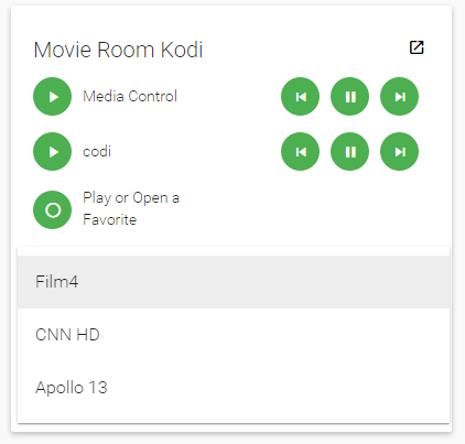

I’ve a channel for Kodi which I hope to use to play things;
The Item shows up like this (it’s a combo box of things in favorites) ;
Can alex being made to handle this channel, by saying something like, “play film4” ?

I had noticed that you can use String to select from a predefined list of options, but that means it’s hard coded list in the Item itself. However, the favourite list is dynamic and changing as the user adds and removed things in the Kodi gui. As this changed in Kodi, the combo box in the Paper UI item changes to reflect the contents… So the alexa prompt would need to match things in the Item, not the hard code list of string literal. In PaperUI, you open the combo box and pick one of the list of strings… Obv I am aming to say soemthing like “play favorite “apollo 13” on kodi”, or something like that. But “apollo 13” won’t be hard coded in the item.
It looks like this;
and you can click the combo to get the full list as below;
I hope I explained that ok!! :slight_smile:

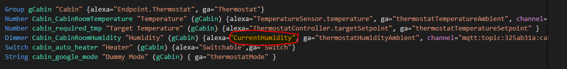

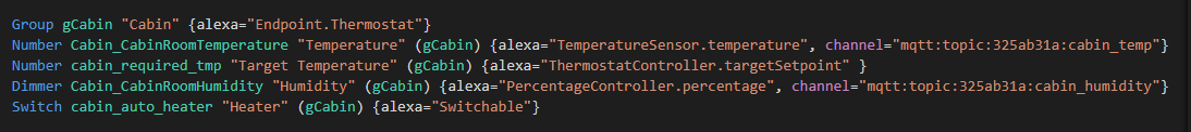

Under the Cabin, I can ask for the actual temp, I can set the target, and I can turn the heater on/off. All those work just fine… but!!! I can’t get it to tell me humidity… I item is there, because I can see it here;
Just can’t get alexi to tell me, Tried all ways of asking, most just say, “that is not support yet”
Is something done wrong?

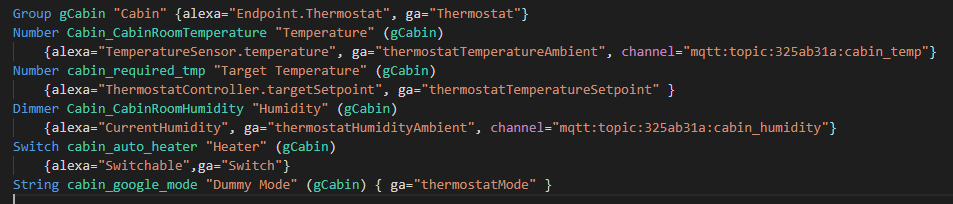

Try using the CurrentHumidity metadata label instead, which translates to a non-controllable RangeController interface.
Getting closer all the time, what’s not right;
This still replies “That’s not support yet”, when asked, “what the humidity in the cabin”
But has not problem with “what’s the temp in the cabin”

Alexa, what’s the cabin humidity?
Not possible for the time being. There is an automated discovery on the Alexa side that is triggered every 24 hours or so. Other than that you will need to manually trigger the discovery.
No, all the things that seem right reply “Sorry, that’s not supported yet”, I change the word humidity to anything else, it goes of and searches the web or something. So I’m sure it’s recognising it as what it is, just not able link it to the item…?

I have linked each item to both Alexa and GA, if I ask GA the same question, it responds correctly with the humidity, so I think it’s an Alexa issue somewhere.
Not sure what to tell you at this point. I just ran a test and it worked on my end. Check your Alexa voice history to see if your requests were understood correctly.
As a side note, looking at your item definition, you should also add the thermostat mode capability as well associated with the PowerController interface (aka Switchable) so you can have the mode setting and turn on/off utterances available.

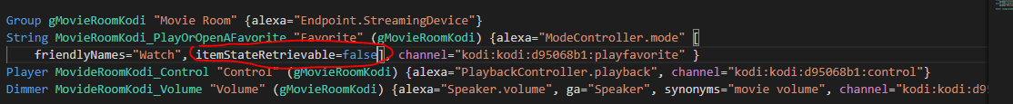

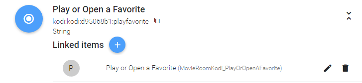

Make sure to go over the troubleshooting documentation related to device not responding. If you modeled a group endpoint for your Kodi device, you need to make sure that all the Alexa-enabled items part of that group are returning valid states.
Thanks @jeshab, that’s working :slight_smile:
I tried both things as I read them from trouble shooting;
This didn’t work;
and, this did;
Working well now. got there in the end.
If Kodi had a few more api calls to hook it better, it could be fully controlled I’m sure, that would be SOO cool :slight_smile: but it’s a good start.
That’s actually the correct way to set it up :+1:
Looking at the Kodi binding code, that channel state gets set to UNDEF after receiving a command.
