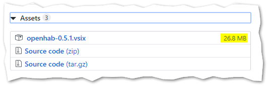

What i already can see is, that space usage optimization had a big impact.
Before webpack:
After webpack:
