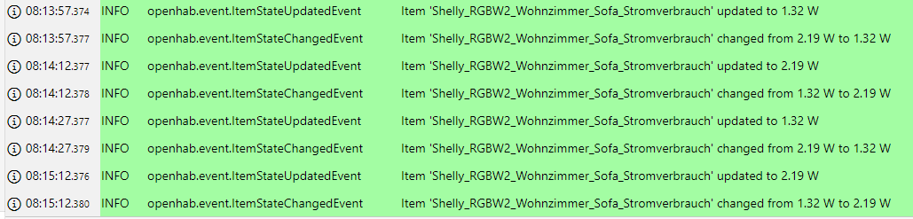

  2. the power consumption is constantly alternating, although on the hardware page of the shelly controller the power consumption seems to be a fix value. This issue doesn’t bother me much but perhaps it gives a clue to issue #1

Okay, it seemed to be a problem with the LED strip. I replaced it, and the new one doesn’t show those fluctuations in the voltage values.
