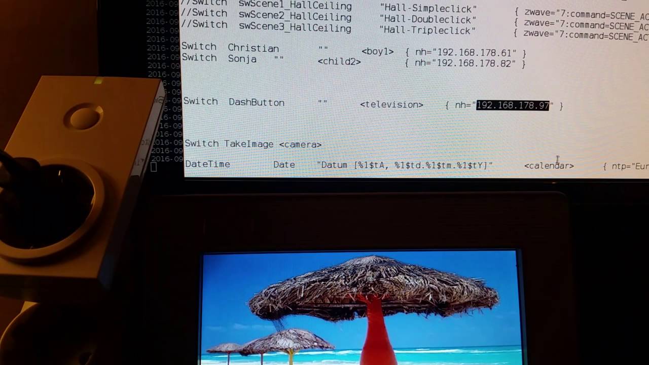

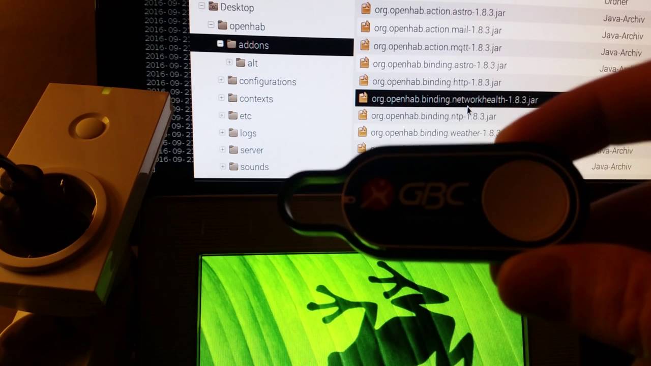

I used Networkhealth, that works very well and it’s easy to configure.
I made a youtube video to explain it in detail:
There is no workaround, hacks or skripts. Just a binding and a little change in the openhab.cfg, that’s it! :grin:
And here the german version:

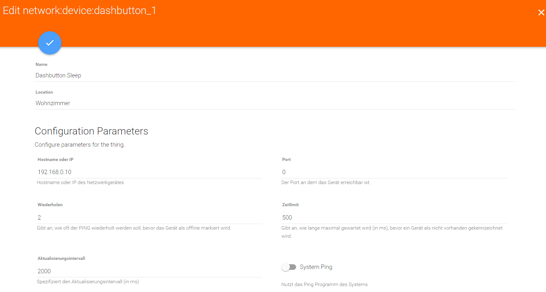

Thanks for that! Did you set the Dash button to a fixed IP address in your router?
Is there a way to archieve this, without increasing the nh-check interval?
I have a lot of nh-items, I do not want to enlarge the traffic for this binding.
My Dash Button setup:
I set a static IP on my Windows DHCP Server (could be done on a router, of course) and disabled Internet connectivity at my Fritz!Box (otherwise the amazon app notified me → dash button not configured)
My FritzBox sets up automaticly fixed IP’s!
You have to increasing the nh-check interval!
BUT GOOD NEWS, you can deactivate amazon app notifications for the Dash Button.
In OpenHAB2 i can set the interval manually :slight_smile:
