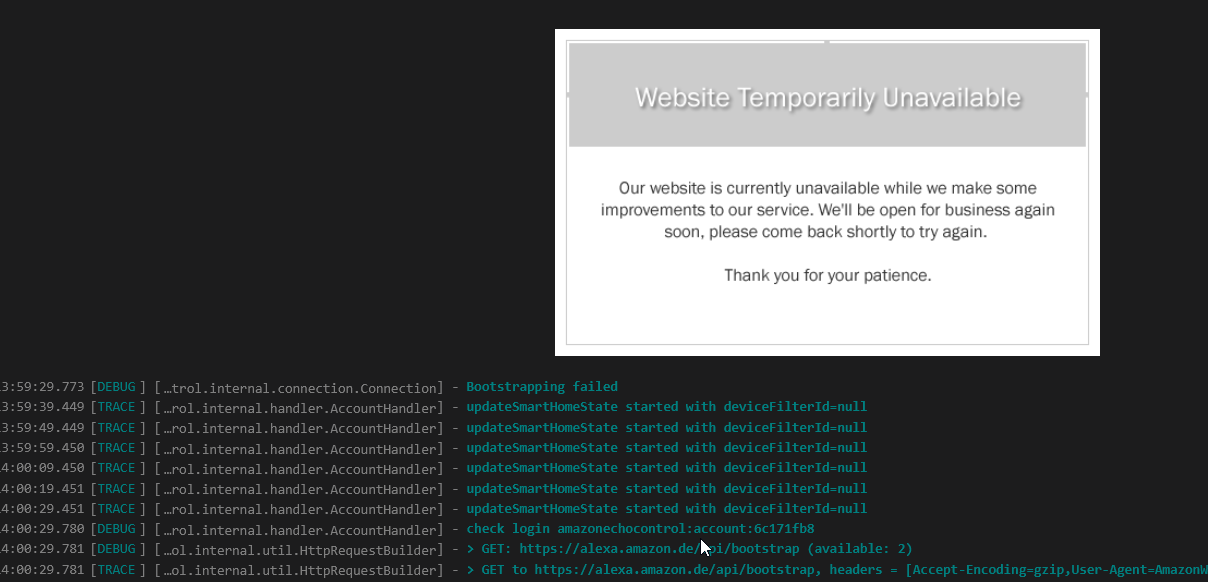

Same here, after OH reboot the amazon account thing is stuck in config pending state and shows link to the echo control servlet:
CONFIGURATION_PENDING
Please login in through servlet: http://openhabian:8080/amazonechocontrol/51bb1c10f3
Link takes me to a login page where I enter my amazon credential and then get returned:
Invalid redirect to 'https://www.amazon.com/ap/signin?arb=
However control of openhab things through my echo devices seems to work normally so the skill still works. It appears to be the echo control binding specifically that is hooped.
Amazon has removed the semi-official bootstrap API. As a result, the Echo binding is broken
@lsiepel is working on a solution👏, but it’s a bigger undertaking
For now, the options are to use Home Assistant or Node-RED and connect to openhab. I went the Node-RED way. It doesn’t cover 100% yet but if somebody wants to participate and improve I’m happy to show the current solution.
