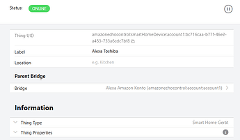

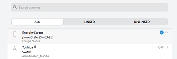

Then I am out of ideas. As you can see from my above screenshots, it is working for me …
