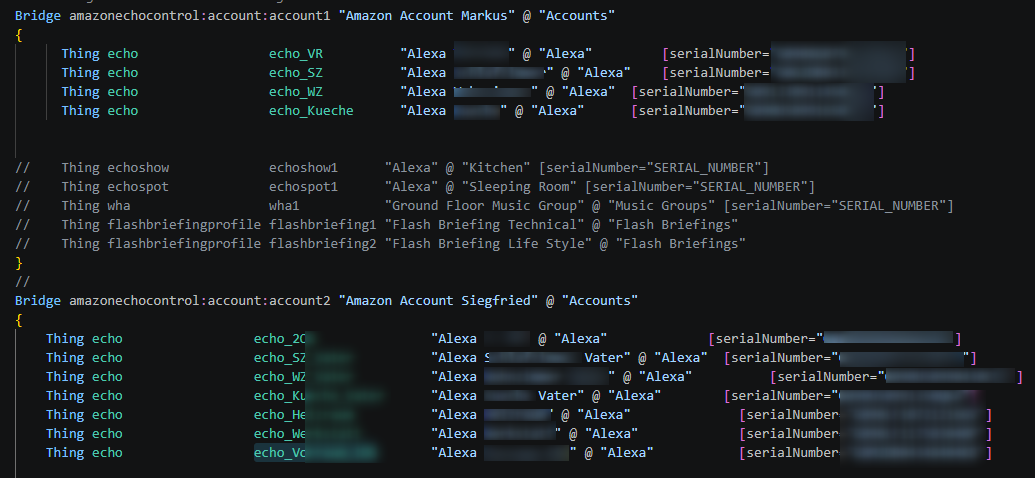

my Amazon Echo binding worked fine for weeks.
Until last week I encounter that it is offline very often.
But I have special configuration.
I use two different Amazon accounts.
Even it was working for a long time, to have 2 differnt accounts online a long time, I have now the situation, that either Account Markus is online or Account Siegfried is online.
I tried to delete all json files in /var/lib/openhab/jsondb and /var/lib/openhab/jsondb/backup
Then I authorized account 2 after an reboot, account 2 was online.
Without reboot I authorized account 1, was also online. A few seconds later account 2 was offline.
Are there any ideas, is there an increased loglevel to get some additional infos?
Regards, Markus
you can set the log level to DEBUG or TRACE (=maximum) to increase logging. It’s under settings - add-on settings - Amazon echo
I tried in the mean time different things, at last resort I asked Gemini AI.
Gemini said, my accounts have no direct separation, so because of cookies Amazon thought 2 different accounts on one device, which is not possible.
what was my solution:
  • delete according json files for account settings in jsondb and backup directory
  • reboot openhab
  • give each account in the thing file an unique identification e.g. Bridge amazonechocontrol:account:account1 “Amazon Account Markus” @ “Accounts” [ clientSerialNumber=“OH5_Markus_App_2026” ]
  • login to account 1 http://:8080/amazonechocontrol/account1 using 2FA
  • close the tab for login
  • open an incognito tab in the browser
  • login to account 2 http://:8080/amazonechocontrol/account2 using 2FA
with this setting both accounts stay active (I hope for long time)
