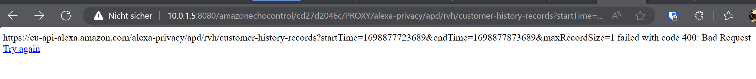

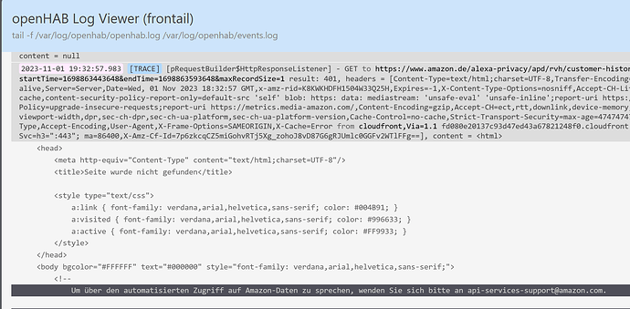

Hi. I created a fresh new openhab(ian) installation and followed your instructions. I have those errors in my logs:
here is full log.
Am I locked by amazon?
2023-11-01 19:32:52.486 [TRACE] [trol.internal.handler.AccountHandler] - updateSmartHomeState started with deviceFilterId=null
2023-11-01 19:32:53.720 [TRACE] [rol.internal.util.HttpRequestBuilder] - GET to URL https://www.amazon.de/alexa-privacy/apd/rvh/customer-history-records?startTime=1698863443648&endTime=1698863593648&maxRecordSize=1, headers = [Accept-Encoding=gzip,User-Agent=AmazonWebView/Amazon Alexa/2.2.556530.0/iOS/16.6/iPhone,Accept-Language=en-US,DNT=1,Upgrade-Insecure-Requests=1], cookies = [session-id=259-8790722-7303664, session-id-time=2082787201l, i18n-prefs=EUR, ubid-acbde=257-9812239-0727736, session-token=2o5SiI2WmaXiVbiOpIgALWlLR7C6RuSbFwBJj96OhfjwrUjOMV0lizIAmP+nEEAxgJSbgBTRdJQE2w02KMy5QUuMt7r1weVGV7M1GQXGB++1kuEwz4JVlii7fVjbWJbsqm8VlXykgkP9q0O/yAntLP0I4WQpS4VS7fdlqFeBadnKQmCvLv6pWNzhye/WIZ3QXW8IrtIU1xi7FvvP6Hak+EtcCRueKdue1+cjaARf9/YUQqjps1Uwckt8FHcGnwsvCoR6KNcau5Gv/m0+alfb/eCQtOKTUKkETf0aPC8QCiKykZxVvt3hGVvhdhId9xkiUKIYg/m95ytizS3mhalL5eXAfzjn1d5K], content = null
2023-11-01 19:32:53.814 [TRACE] [pRequestBuilder$HttpResponseListener] - GET to https://www.amazon.de/alexa-privacy/apd/rvh/customer-history-records?startTime=1698863443648&endTime=1698863593648&maxRecordSize=1 result: 401, headers = [Content-Type=text/html;charset=UTF-8,Transfer-Encoding=chunked,Connection=keep-alive,Server=Server,Date=Wed, 01 Nov 2023 18:32:53 GMT,x-amz-rid=W0N6XSWP9VFHP6BD5YFV,Cache-Control=no-cache,Expires=-1,Accept-CH=ect,rtt,downlink,device-memory,sec-ch-device-memory,viewport-width,sec-ch-viewport-width,dpr,sec-ch-dpr,sec-ch-ua-platform,sec-ch-ua-platform-version,Accept-CH-Lifetime=86400,Content-Encoding=gzip,X-XSS-Protection=1;,Pragma=no-cache,X-Content-Type-Options=nosniff,content-security-policy-report-only=default-src 'self' blob: https: data: mediastream: 'unsafe-eval' 'unsafe-inline';report-uri https://metrics.media-amazon.com/,Content-Security-Policy=upgrade-insecure-requests;report-uri https://metrics.media-amazon.com/,Strict-Transport-Security=max-age=47474747; includeSubDomains; preload,Vary=Content-Type,Accept-Encoding,User-Agent,X-Frame-Options=SAMEORIGIN,X-Cache=Error from cloudfront,Via=1.1 fd080e20137c93d47ed43a67821248f0.cloudfront.net (CloudFront),X-Amz-Cf-Pop=FRA56-P5,Alt-Svc=h3=":443"; ma=86400,X-Amz-Cf-Id=IOE99Lydmx2hHRvyg4cR3P8ULX9ErmvNnBZp77SetpXYXHcMFnHO9Q==], content = <html>

2023-11-01 19:32:53.814 [DEBUG] [pRequestBuilder$HttpResponseListener] - Retrying call to https://www.amazon.de/alexa-privacy/apd/rvh/customer-history-records?startTime=1698863443648&endTime=1698863593648&maxRecordSize=1

2023-11-01 19:33:00.072 [INFO ] [ntrol.internal.connection.Connection] - getting activities failed
org.smarthomej.binding.amazonechocontrol.internal.ConnectionException: https://www.amazon.de/alexa-privacy/apd/rvh/customer-history-records?startTime=1698863443648&endTime=1698863593648&maxRecordSize=1 failed with code 401: Unauthorized

	at org.eclipse.jetty.util.thread.strategy.EatWhatYouKill.doProduce(EatWhatYouKill.java:315) ~[bundleFile:9.4.50.v20221201]
	at org.eclipse.jetty.util.thread.strategy.EatWhatYouKill.tryProduce(EatWhatYouKill.java:173) ~[bundleFile:9.4.50.v20221201]
	at org.eclipse.jetty.util.thread.strategy.EatWhatYouKill.run(EatWhatYouKill.java:131) ~[bundleFile:9.4.50.v20221201]
	at org.eclipse.jetty.util.thread.ReservedThreadExecutor$ReservedThread.run(ReservedThreadExecutor.java:409) ~[bundleFile:9.4.50.v20221201]
	at org.eclipse.jetty.util.thread.QueuedThreadPool.runJob(QueuedThreadPool.java:883) ~[bundleFile:9.4.50.v20221201]
	at org.eclipse.jetty.util.thread.QueuedThreadPool$Runner.run(QueuedThreadPool.java:1034) ~[bundleFile:9.4.50.v20221201]
	at java.lang.Thread.run(Thread.java:833) ~[?:?]

You are missing a lot of cookies in your request. It looks like the registration went wrong.
I found the cause of that, but I’m not fully sure how to fix that. I’ll keep you posted.
I re-registered with the same result. accessing manual does work.
then I restarted openhab instance and it just worked. -.-

one question remains: In the workaround last month, I used the proxy and node-red to extract the latest requests and (split optiona) reacted to it.
http://10.0.1.5:8080/amazonechocontrol/AmazonKonto/PROXY/api/activities?startTime=&size=2&offset=1
The proxy is hardcoded to another url now,
Can you tell me the right proxy url to get the history myself?
