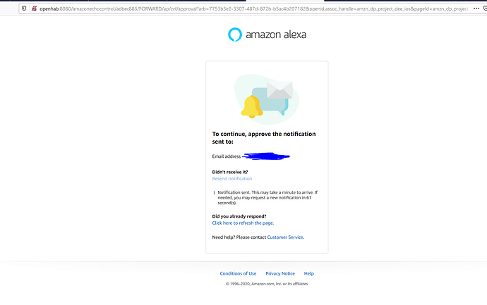

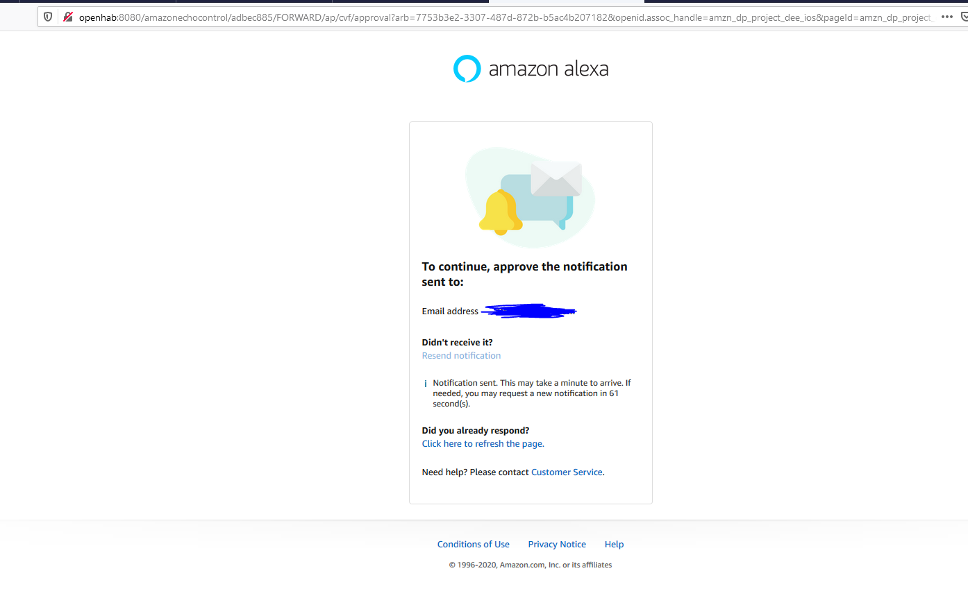

When I try to login, i will immidietaly get to the next page, where my amazon account needs to verify the application.
-> now my problem, the website refreshes automatically in around 5 seconds.
the email -> which i need to accept doesnt come that fast… and when the website is refreshed it generates a new verfiy key which i also need to accept by email…
i didnt figure out, why the website refresh automatically and i cant stop it…
Did anyone else had this problem before or can help me with that ?

so I tried a diffrent Browser, now i use Internet Explorer.
Which doesnt refresh automatically.
When i logged into the webpage, I am able to verify the access with my Email.
But, when i approve it nothing happend -> there is a little button “already activate click to refresh”
After i clicked on it, i get thrown to the mainpage and must login again.
This error occurs all the time.

correct, but this is not the 2FA.
It’s just a notification when amazon think that I got hacked or something like that.
It would be fine when I could deactivate this…
I activated the 2FA with SMS and also with app -> tried both.
When i log into my amazon account with the retail link I need to log in with the “correct” 2FA in my case -> SMS
I dont know why this notification pop up everytime
I’ve updated OH to 2.5.10 and activated 2FA again.
Still not possible to login.
Same behavior as before, the Log-In Site refreshs nearly instantly and i still need to approve my login with an Email Notification (No its not the 2FA -> 2FA is over my App and is working correctly when i log into amazon via retail link)
