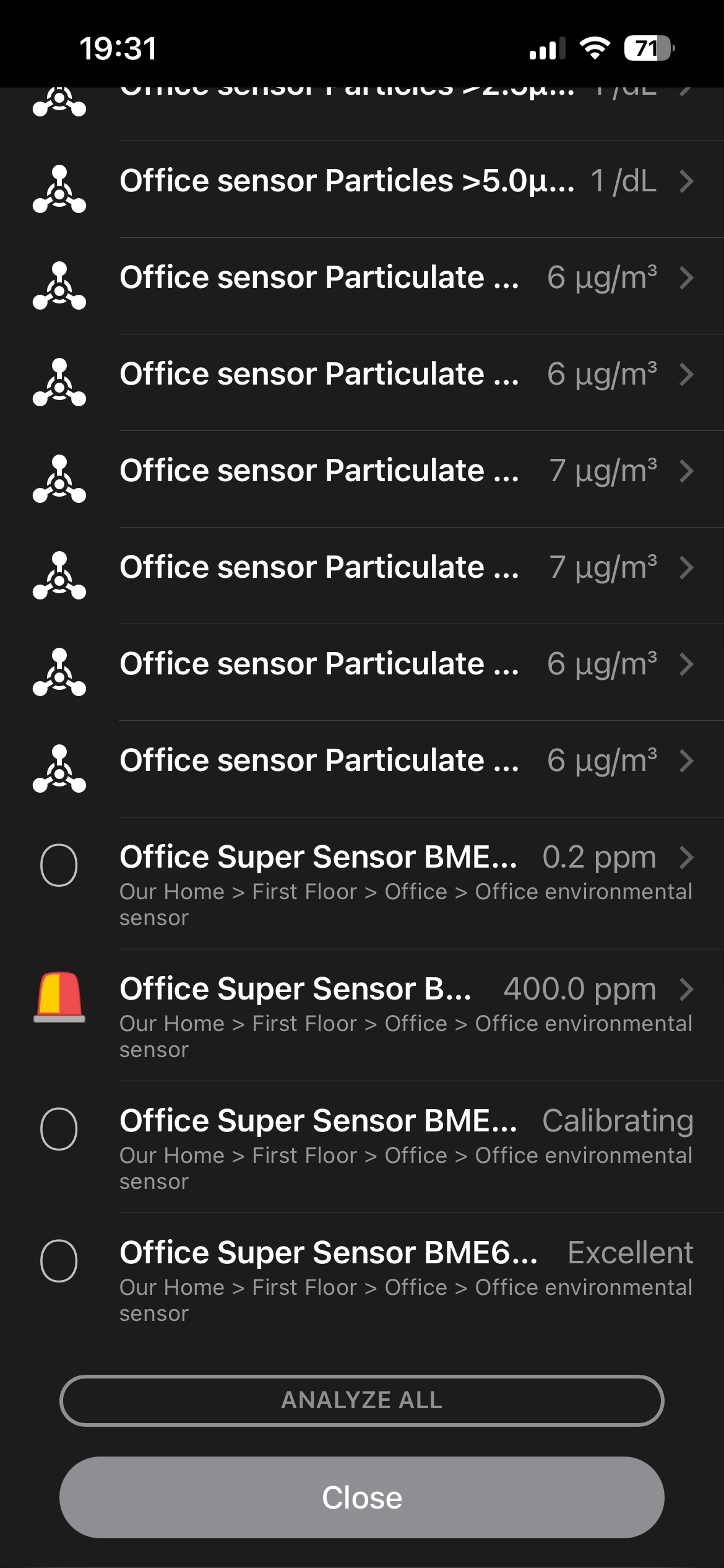

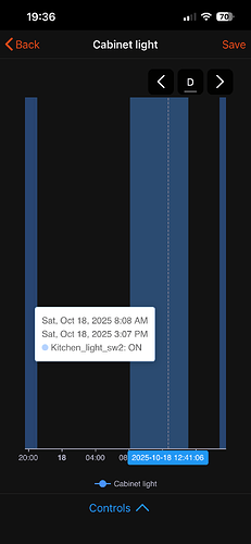

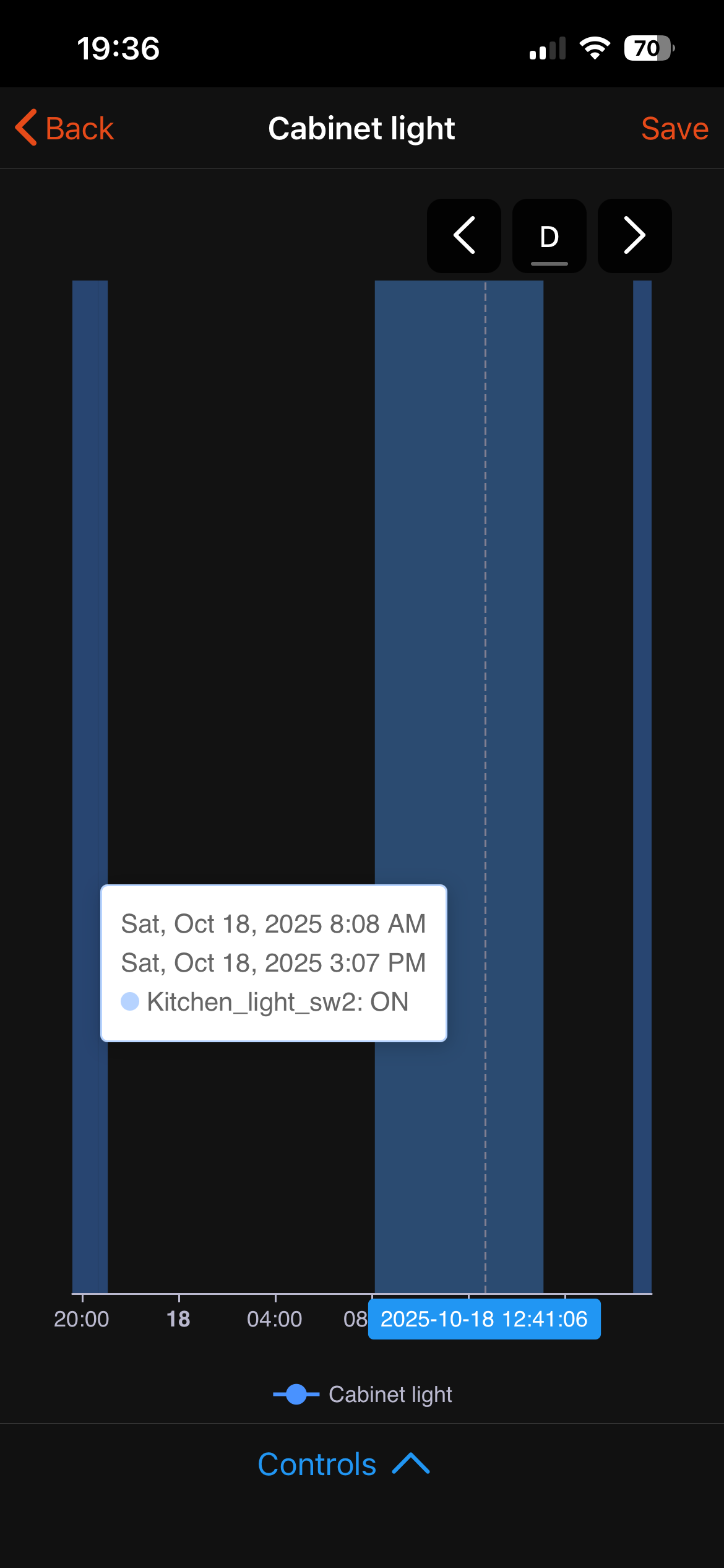

Right so , we have the nifty “analyze” graph in OH which works great with switches and all kinds of values:
But for string items I haven’t been able to figure out how to get a similar graph view. For example:
I have a bme688 that has an item that switches between calibrating, calibrated, uncertain, stabalyzing. And I would like to have a graph showing the ins and outs of these values directly on OpenHAB exactly like I can see how long a switch was on or off.
Is this something that I can work natively in OpenHAB?

Another would be to create switch Items for each state and flip them ON/OFF as the device transitions through the various states.
Instead of a line graph you’ll get the bars of color (each switch will get it’s own color) like in your screenshot.
