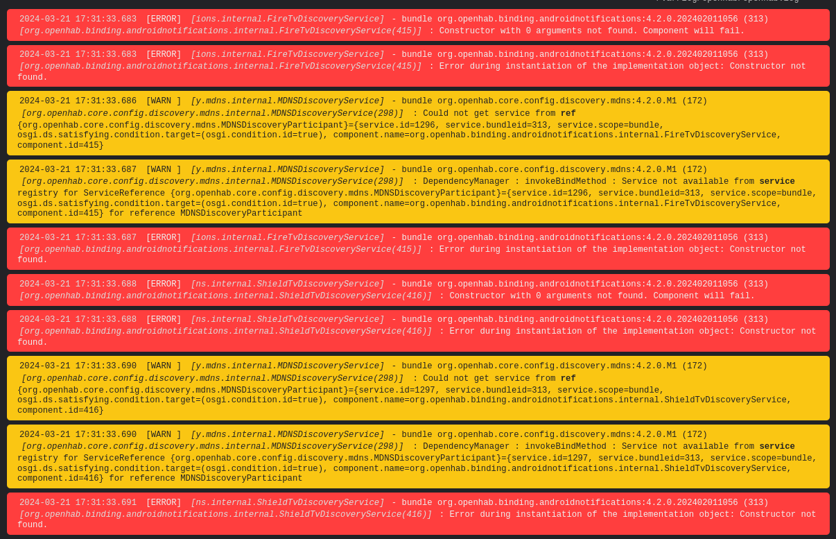

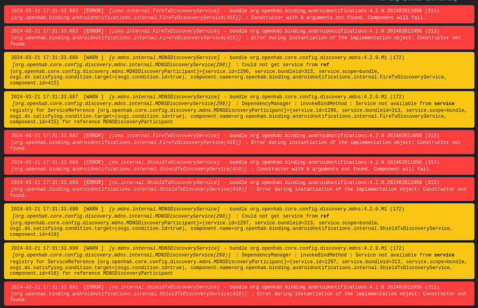

  1. I can install the binding, and it is working, but see error message below.

Yes I have fixed this but can not make a build at the moment and test it. The error will only affect discovery and not the operation, so just add stuff manually.
