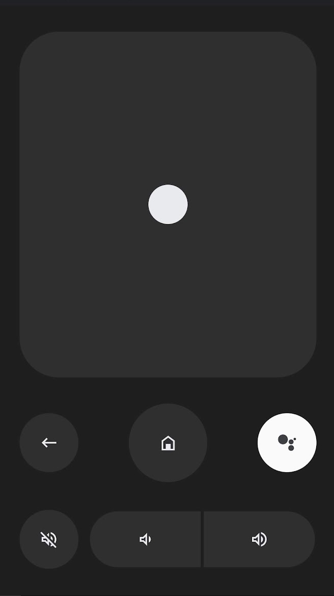

The volume controls in the Google TV app show up as buttons when you go into the “TV Remote” screen.
