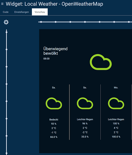

I struggle a little:
My item:
String					W_OWM_CondDay0	        "FC Cond"													(G_jdbc,Group_HabPanel_Dashboard)               {channel="openweathermap:onecall:account:local:forecastToday#condition"}
This returns “Mäßiger Schnee” because I am in Germany
(some snow or similar).
As you can see I don’t use a transform map file (and I would like to use the German condition in habpanel.
So how to get the right (englisch) name of the condition linking to the right icon?
Is there a way instead of renaming the icons?
EDIT:
I found the solution:
I can use “ignoreTransform” by setting this to true:
src="/static/icons/climacon-{{ itemState('W_OWM_CondDay0', true) }}.svg"
EDIT II:
Too early happy:
It seems to catch the icons.
But all look the same and it’s only working in the preview (Chrome), not on the real habpanel view (e.g. firefox)
It looks like it’s catching this icon for all cases.
climacon.svg
I just started to transform back to English:
Bedeckt=cloud
Hochnebel=cloud_fog
Nebel=cloud_fog_alt
Hagel=cloud_hail_alt
Heiter=cloud_sun
Sonnig=sun
Sturm=wind
Regen\ und\ Schnee=cloud_snow
Leichter\ Regen=cloud_drizzle
I mapped these based on guessing.
So if someone has done this I would appreciate your help.
