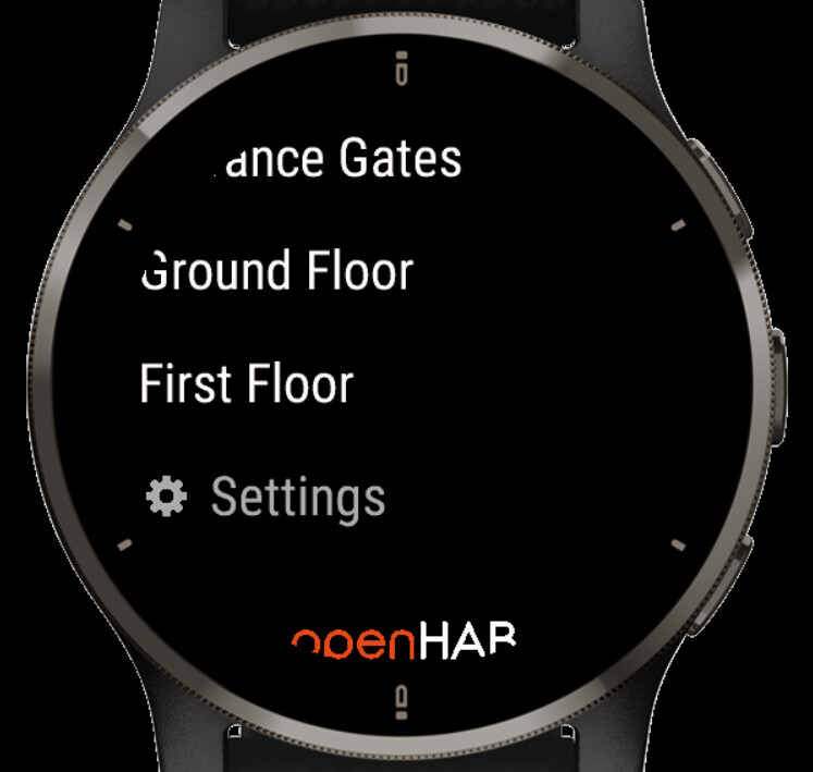

In the next version, the settings menu will be implemented differently for touch devices.
Note: By touch devices, I’m referring to models primarily designed for touch input (like the Venu and Vivoactive series), in contrast to button-based devices such as the Fenix or Forerunner series. While the latter may have touchscreens, their interaction model is still centered around button use.
On touch devices, the settings will appear as a standard menu entry, rather than as a parallel menu positioned below the footer. This approach aligns better with the user interface conventions of touch-centric devices.
@stonke, my expectation for the menus is that when navigating into a submenu and then returning, the parent menu should restore its previous scroll position. In the simulator, this doesn’t seem to work correctly - on return, the focus shifts lower than where it was left. Do you observe the same behavior on your actual device?

@stonke, one more question: the height of each menu item is relatively small. I think that works well on button-operated devices, but do you think it would make sense to increase the height for touch devices? Or does the current layout work well as-is?

Height of items is really acceptable (even could be smaller) especially if we compare to APIcall app
It could easily handle 6 or 7 items and still stay clickable.
About menus behaviour I made short video that should help(onedrive link below). Looks like its not what you expected:
