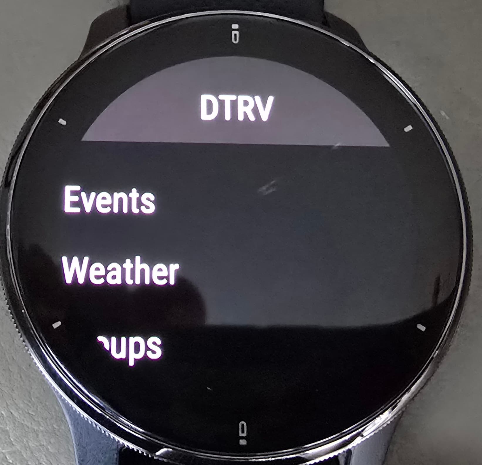

That is what log-viewer shows about garmin.sitemap:
Openhab.core.model.core.internal.ModelRepositoryImpl	Validation issues found in configuration model 'garmin.sitemap', using it anyway: Frames must not contain other frames
sitemap garmin label="DTRV" {
	Frame label="Events" {
		Frame item=DateEventNextLeft label="Event"
			Text item=DateEventNext label="Day"
		Frame item=DateFamilyNextLeft label="Family"
			Text item=DateFamilyNext label="Day"
		Frame item=DateHolidayNextLeft label="Holiday"
			Text item=DateHolidayNext label="Day"
		Frame item=DateFriendsLeft label="Friends"
			Text item=DateFriendsNext label="Day"

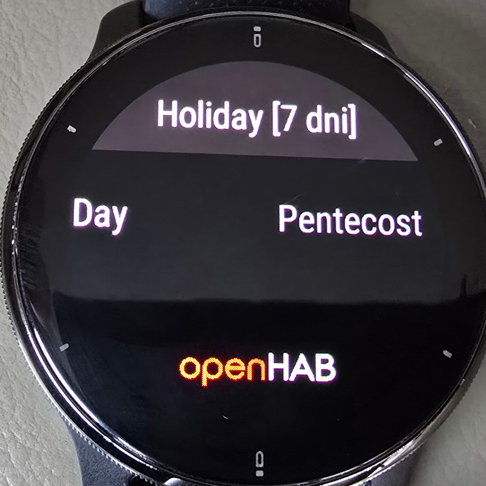

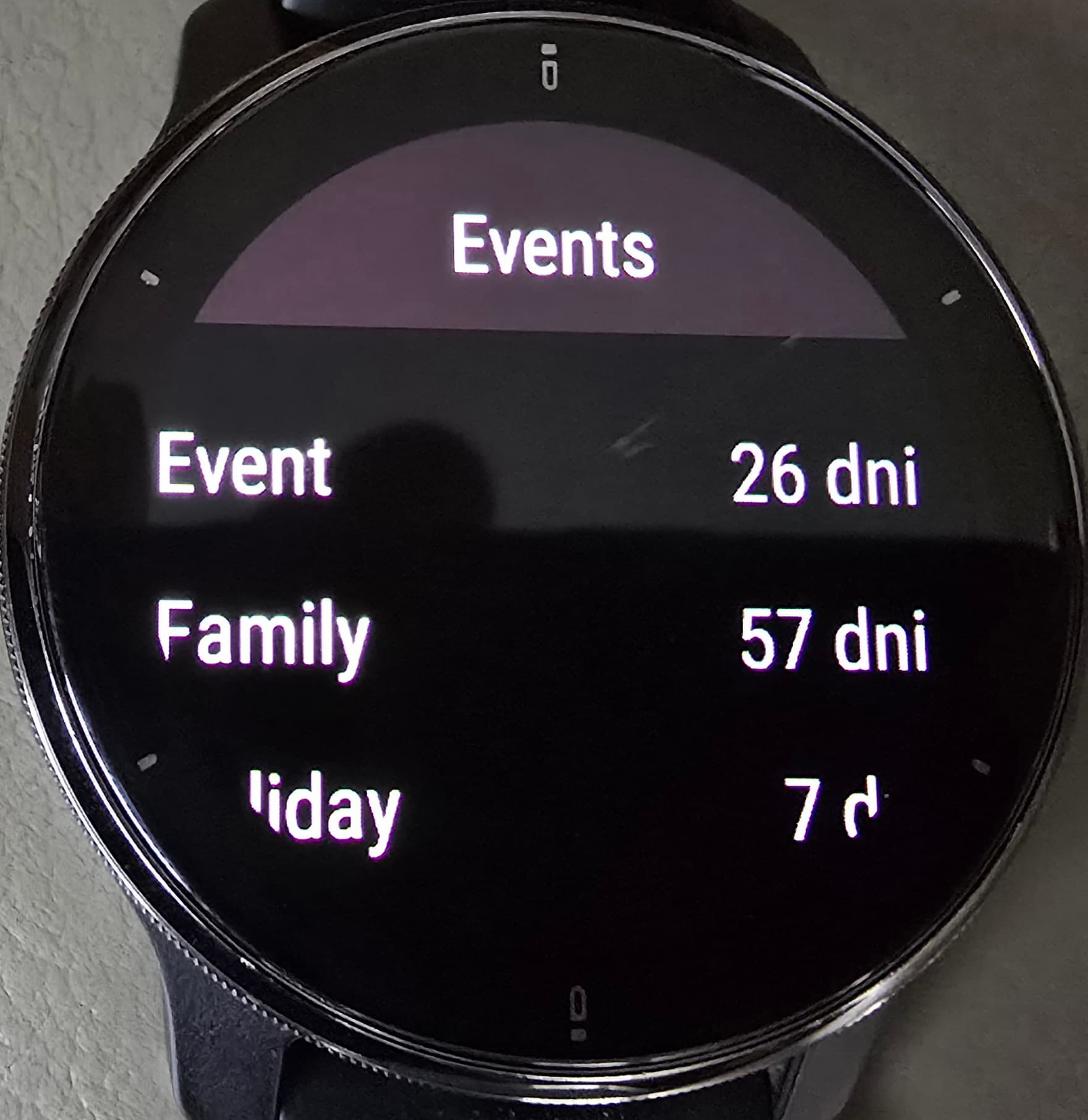

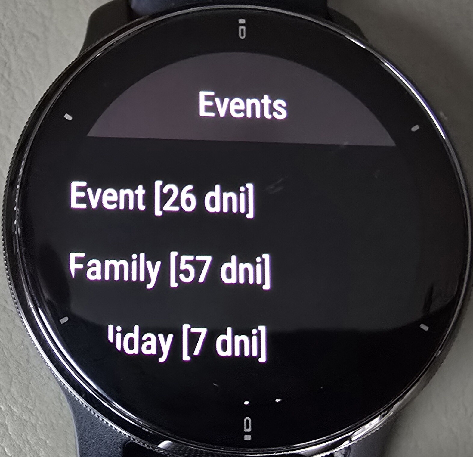

{here will attach pictures of watch display]
But if sitemap code changed to:
		Text item=DateEventNextLeft label="Event"
		Text item=DateFamilyNextLeft label="Family"
		Text item=DateHolidayNextLeft label="Holiday"
		Text item=DateFriendsLeft label="Friends"
then sitemap log-viewer does not return error BUT it is not possible to check the name of holiday. Display looks like this but can not click item to go inside
Sound fine for me.
Thanks for the examples! I wasn’t aware that a Frame can also be associated with an item. While that could be inferred from item being a common parameter, it’s not mentioned in the Frame specification or illustrated in any of the examples in the documentation.
I also didn’t find anything in the docs that explicitly states whether a Frame can or cannot contain other Frame elements—but there’s no example that shows this being done either.

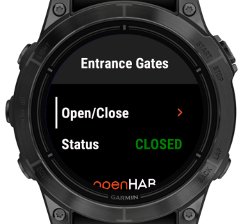

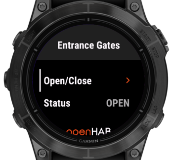

Another small change is that empty mapping entries are now supported for generic switches. This can be useful when the label of the sitemap element is already descriptive enough to explain the action being triggered.
Below is an example. The displayed entrance gate has a toggle switch—setting it to ON will trigger the gate operation, and it automatically resets to OFF after one second.
In this case, OFF is mapped to an empty string, and ON is mapped to “OK” to briefly indicate that the command was processed:
Switch item=Entrance_Gates_Power label="Open/Close" mappings=[OFF="", ON="OK"]

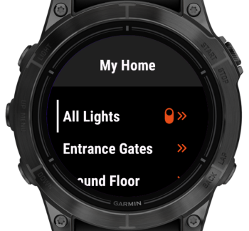

Regarding state changes: it appears that the Basic UI implementation of sitemaps only allows nested elements under Frame and Text, and does not permit changing the state of the item associated with a Group element. Therefore, the fact that the Garmin app does not support state changes for menu items with nested elements is consistent with the Basic UI.
To improve navigation clarity:
  • A double-chevron now indicates that a menu item will open a submenu.
  • A single chevron continues to indicate that selecting the item will trigger a state change.
Here’s an example. The first screenshot shows a sitemap using only Frame elements. The second screenshot includes a Group element with a group of Switch items.

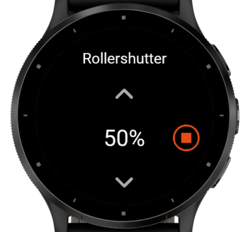

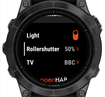

  • New Rollershutter widget
    A dedicated full-screen widget has been added for Rollershutter items.
  • Support for Setpoint element
    The Slider implementation aligns with how Setpoint is used in other UIs. As a result, Setpoint is now supported and handled by the same widget. The only functional difference is that Slider supports releaseOnly, while Setpoint does not.
  • Support for Selection element
    Selection elements are now supported and are handled the same way as Switch elements, since their behavior is identical to to the app’s existing generic Switch widget.
  • Documented support of Default elements
    Documentation has been updated to reflect support for the Default element. Since the openHAB server resolves Default to a specific type, no additional implementation was needed. However, only resolved types already supported by the app will work correctly.
Screenshots of the New Rollershutter Widget

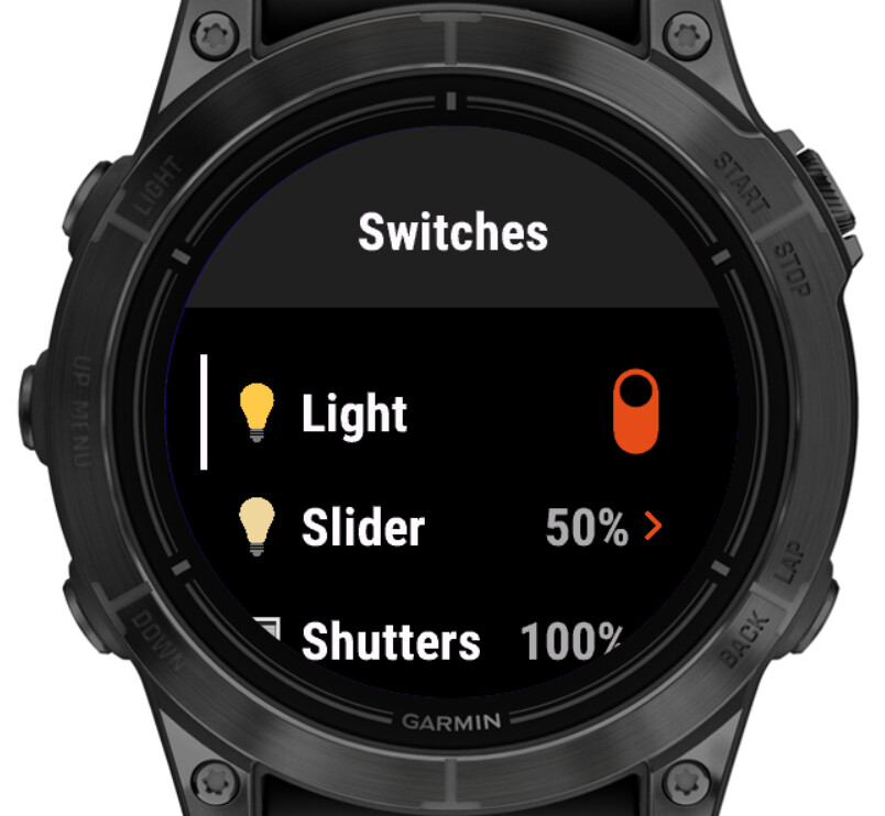

I tested this locally, and for me it works as intended. For example:
Switch item=TEST_SWITCH label="Light [(%s)]" icon=light
Displays like this:
Note on the side: as you can see, the next version will come with icon support.
