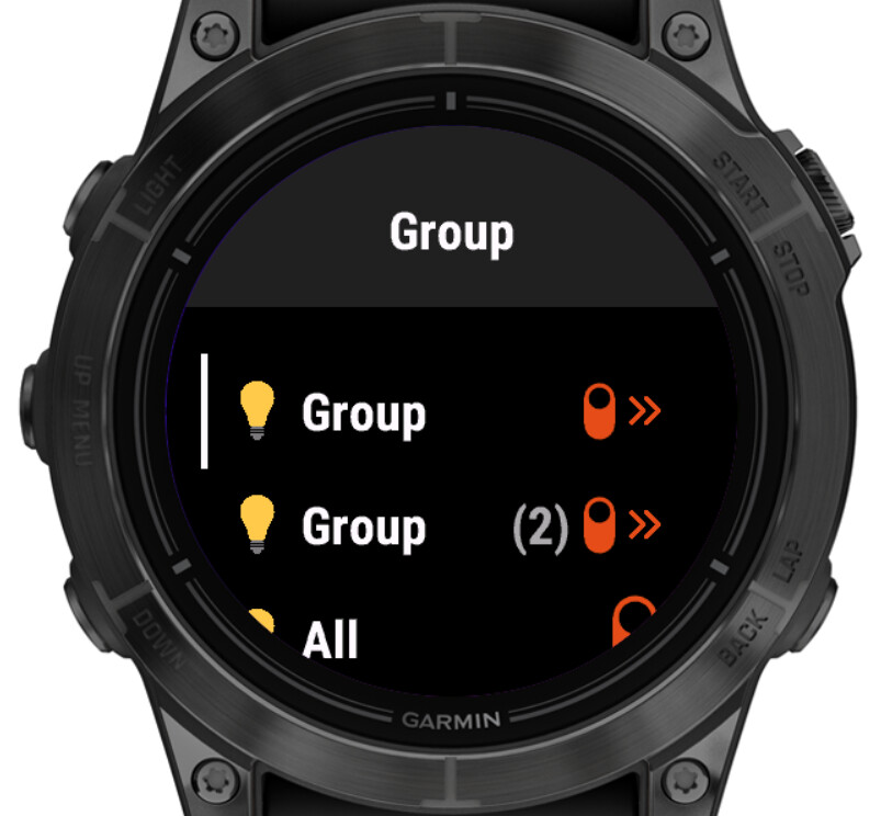

Display of rendered state next to toggle switches
If a display pattern is defined for a Switch item—either in the item metadata or the sitemap—the resulting string will now be shown next to the toggle switch.
Example:
Group item=TEST_GROUP label="Group [(%d)]"
This would render as follows (see second menu item):
@stonke, let me know if this works for your use case.

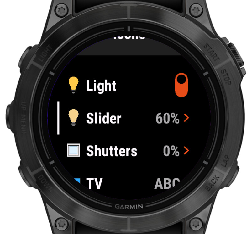

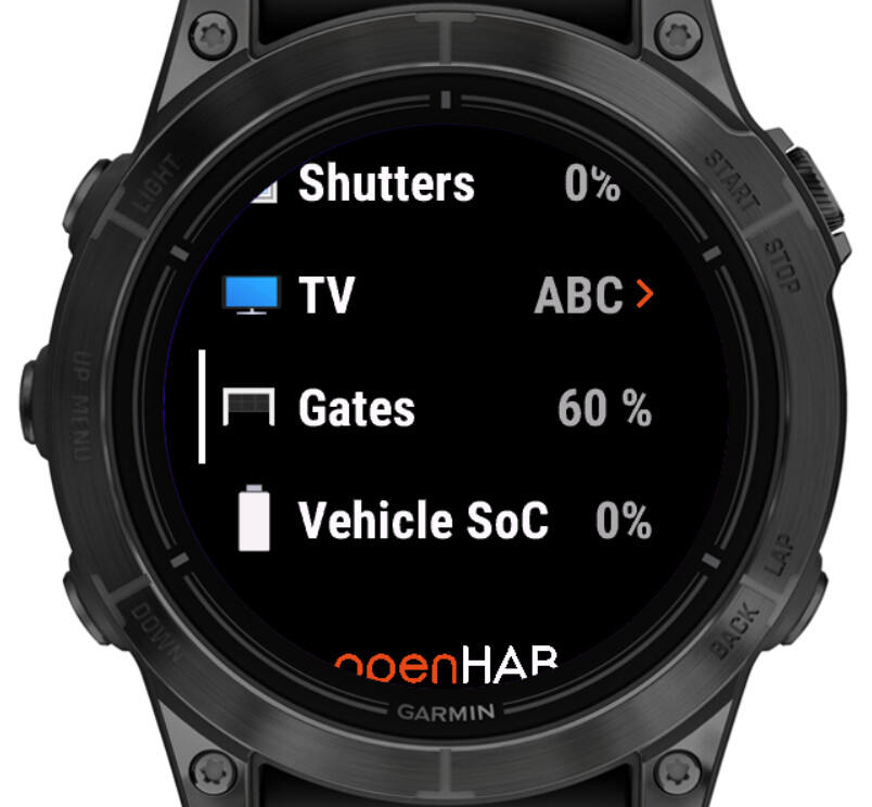

Icon support
Icons can now be displayed next to items, either defined directly in the sitemap or via item metadata.
If an icon is defined in metadata but you don’t want it to appear, you can suppress it by setting the icon parameter to an empty string ("") in the sitemap.
The icons are built into the app, and while the current set is limited, more can be added on request. You can find the full list of supported icons in the Icons section.
Wherever openHAB supports dynamic state-based icons (e.g., for lights, rollershutters, or garage doors), the app supports them too.
Example screenshots:
